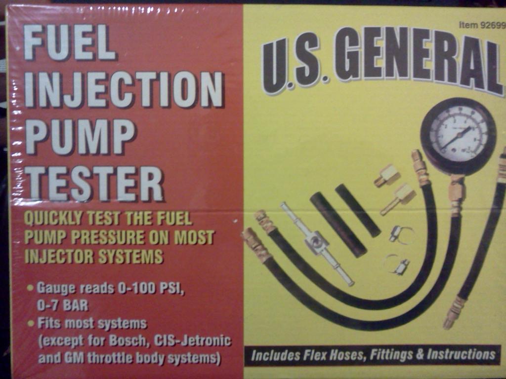

Will this work???
I was at Harbor Freight today and saw this fuel injection pump tester on sale for $20 so, I bought it.
Please tell me this will be good enough to test what you guys say is needed/helpful??
My last post I had meant that when cranking it, it does NOT chug or give any indication that it is trying to start.
I just got home so I am about to go out and see if I can get any codes.

Those pressure testers are great tools too. But.....the likelihood of it being quality coming from HF is going to be slim. No matter because as long as it tells you within a certain parameter that your actually getting fuel pressure, will be better than not knowing anything at all.
Since you just changed out the fuel filter you know its clean so where you'll want to connect the test line is to the test port on the inlet of the VP. Bump the starter and see what it tells you. Then with the engine running see what the fuel pressure is while idling. If your fuel pressures are below 10 psi then thats why you had so much trouble bleeding out the fuel system.
