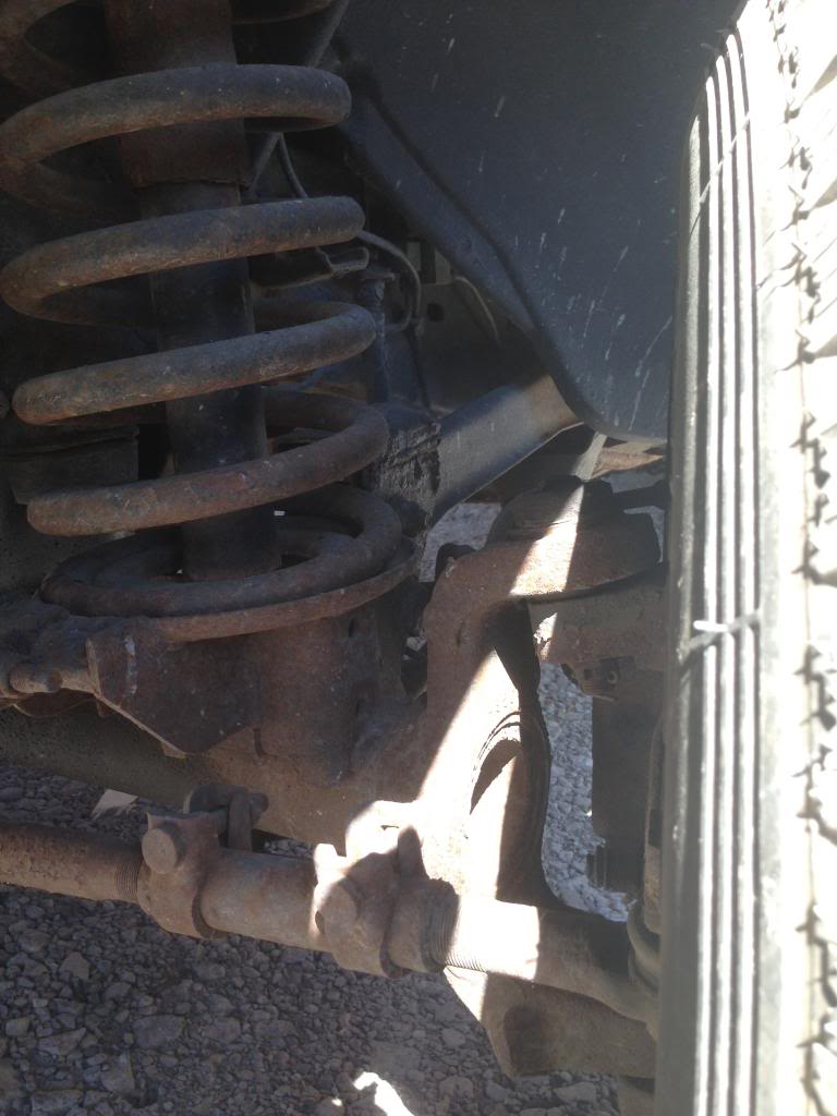

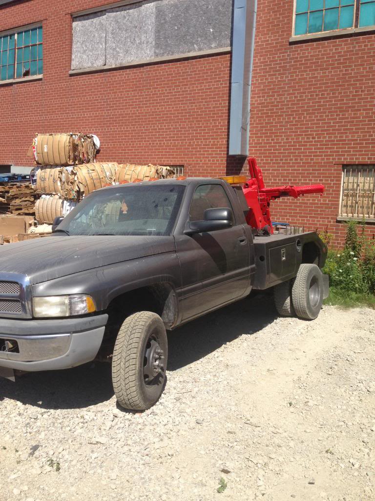

2001 or 02 i forget what year he told me dodge 3500 with a straight axle built like a 4x4 but only two wheel drive 5 speed 24 valve. is this a rare truck to find cuz ive never heard or seen one. what do u guys know about this ?

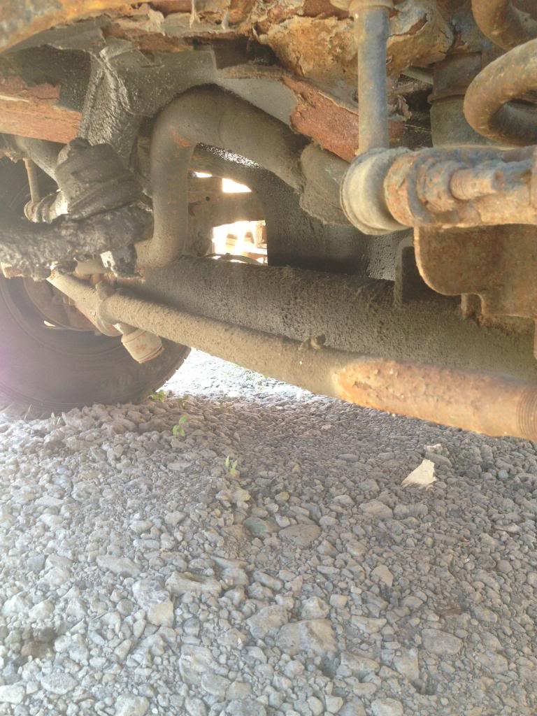

Looks like a homemade job from a dana 60 to me. Owner cut out pumpkin and replaced center section with tubing, welded and ground down, painted etc.
Why? not sure. Thought maybe a Ford Super Duty swap but those aren't tube, they are I-beam shaped.
Dodge heavy duty front ends are two piece a-arm type IIRC.

That rear leaf pack is quite a stack for a 3500, but it is a wrecker body on there...

Yes that was an option for a 2WD truck with higher GVWR than the normal independent suspension would allow. There weren't many sold, but I remember 2 that I used to work on all the time. Both were 95s.

Looks like the standard chassis cab config to me. We've got a flatbed dodge chassis cab here at work. Its an 01 or 02, V8 gas auto, 2wd. front axle is a solid tube and lots of springs on the rear.

Yep, standard cab and chassis, I finally saw the pictures. One other oddity with the cab and chassis, there is about a 2" or so wheelbase difference, you can put a dually bed on one, but it leaves a gap between the bed and the cab.
Them was some heavy duty mothers.
Another oddity is a 2WD 3/4 ton with a factory dummy transfer case and lever, it was an option so you could run a PTO. I have only ever seen 2 of those.
