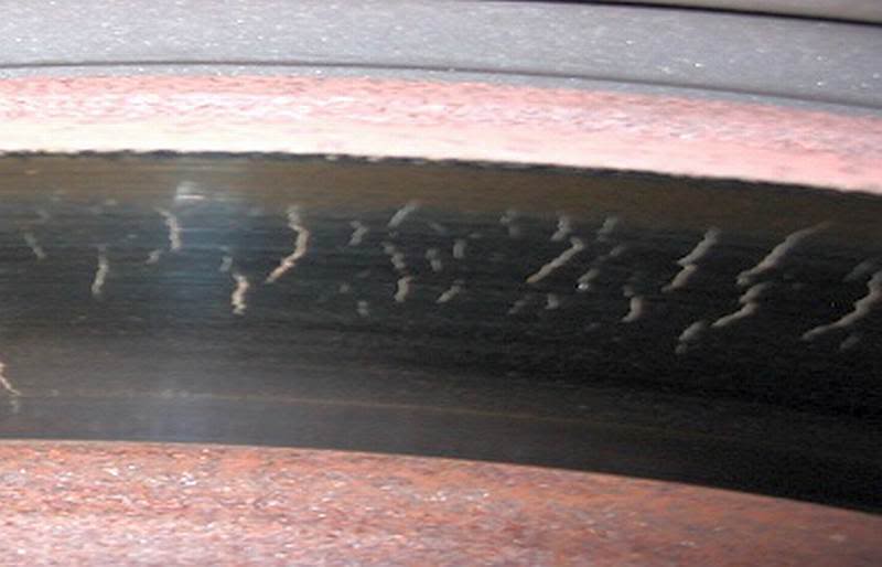

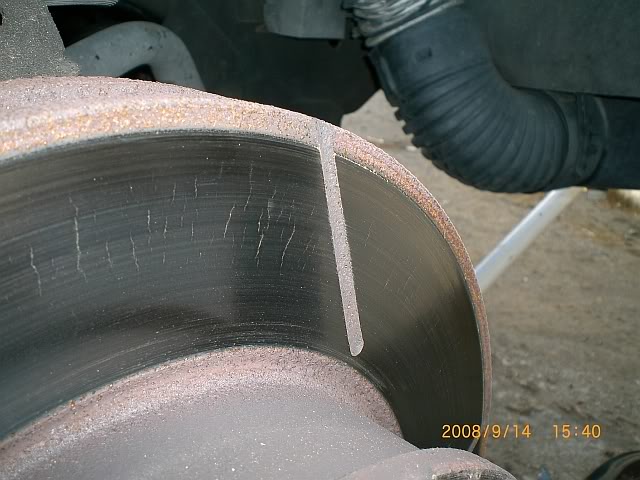

By the way, solid rotors crack as well -
http://www.rv.net/forum/index.cfm/fu...d/26803745.cfm
http://www.irv2.com/forums/f22/safet...ure-57771.html
Wow....doesn't look like those "filets" helped that rotor any.....
Old Sep 10, 2013 | 05:46 PM
Dane's Avatar
Joined: Oct 2002
Posts: 189
That rotor doesn't have any.
Old Sep 10, 2013 | 06:46 PM
Lary Ellis (Top)'s Avatar
Admin Team Leader
Posts: 15,514
Likes: 207
Then what are the slots ground in it? they look similar to what you posted.
