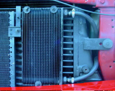

Mine gets so hot that the ip starts to detune to save its self. It takes a small while, but my return line would get so hot it would burn ya. I ended up installing a trans cooler on the return near the tank. I also put a valve on it so I can bypass the cooler in winter.

That's what I did but in the cold weather, I cover mine with a high zoot cover....duct tape

would it hurt to put it(cooler) on the feed line to the pump instead of a return line
I dont think it would hurt. Maybe a slight psi drop due to the twists and turns of the cooler.
I put mine on the return line on purpose...no pressure. It's gravity all the way back to the fuel tank...no spray in the event of a leak.
