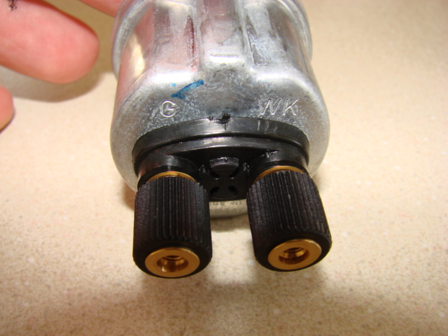

I changed the part and oil pressure back to normal. I attached some photo's of the oil pressure sensor, it screws into the oil filter housing and has one wire that goes to the terminal marked "G".
Thanks for the help.
