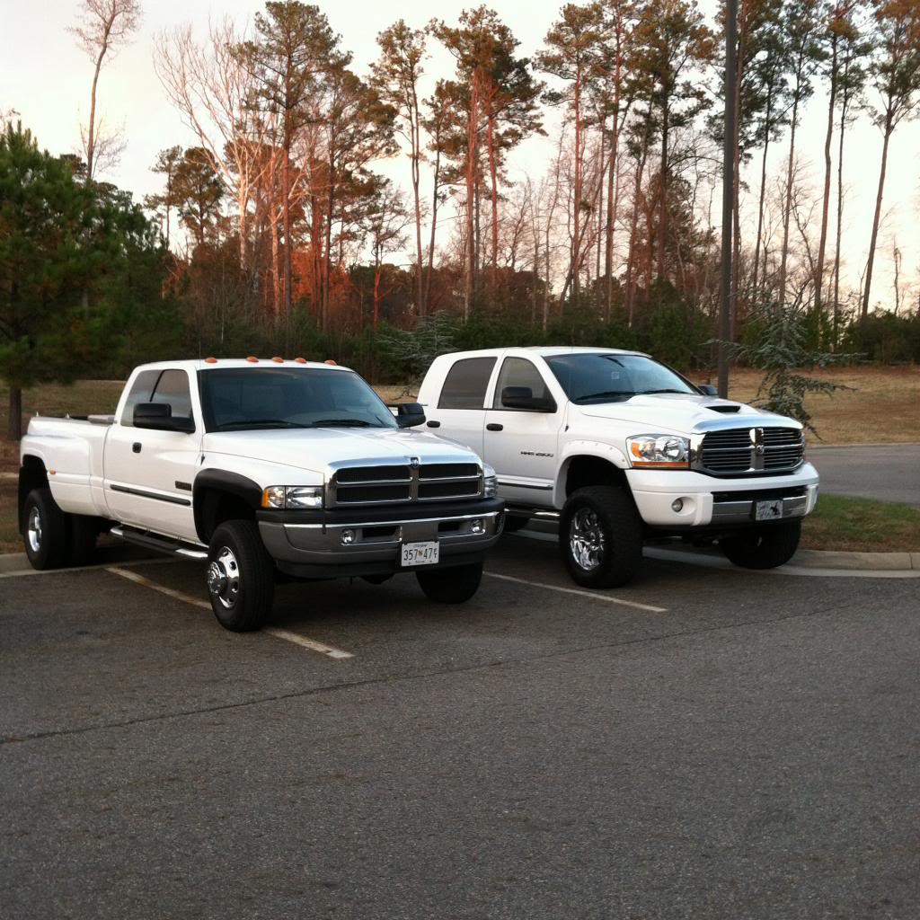

The broken truck is my old 2500 work truck so I'm just glad she is up and running at all. I have a nice new to me 01 3500 with 60k miles on it strait from nice dry AZ. She will stay in the garage all winter unless the other truck dies again.
