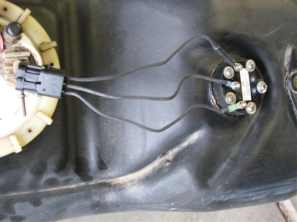

Here are a few pictures
Attached Thumbnails Fuel Level Sender, Capacitance Type Install Notes-img_0066.jpg   Fuel Level Sender, Capacitance Type Install Notes-img_0067.jpg   Fuel Level Sender, Capacitance Type Install Notes-img_0068.jpg   Fuel Level Sender, Capacitance Type Install Notes-img_0069.jpg   Fuel Level Sender, Capacitance Type Install Notes-img_0071.jpg

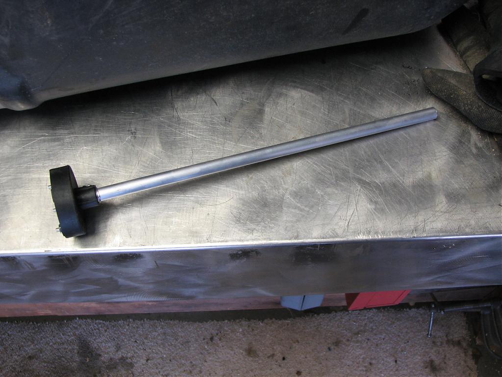

And a couple more
Attached Thumbnails Fuel Level Sender, Capacitance Type Install Notes-img_0072.jpg   Fuel Level Sender, Capacitance Type Install Notes-img_0077.jpg   Fuel Level Sender, Capacitance Type Install Notes-img_0078.jpg

Originally Posted by BarryG
And a couple more
Hey Barry G. Was looking at your pics and was confused to why you wired back into the old module instead of from the wires from the truck. Dont understand how you are getting power and getting the fuel gauge to work

Wow this has been awhile
in any case I did not go back to the oem sender. That pic while it shows the plug on the old sender it is just laying there. The other side/half of the plug is just not in the picture. I cut off the original oem electrical plug and wired in those GM weather pack plugs. The oem harness has multiple wires in it but the diesel only uses two of them can’t remember which two but I may have noted it in this thread. The new sender needs three wires the two from the oem sender and an additional 12v ignition on only power wire that’s is why I used a 3 terminal GM weather pack plug
fyi I added length to the wires and length to the fuel lines which I replaced from the oem sender unit to filter head. I had done that previously so as to make dropping the tank easy (I had dropped it multiple times previous to this install). That way I could drop the tank and disconnect the fuel lines and wire harness on the floor instead of trying to fight them with the tank in place
