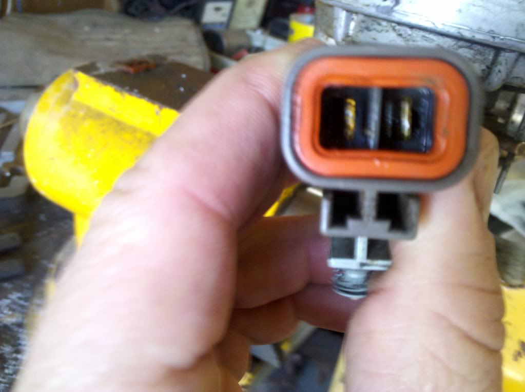

Old Nov 5, 2010 | 07:33 PM
99NVRam2500's Avatar
Joined: Oct 2004
Posts: 93
From: NV
Remove these 3 TORX screws.
Old Nov 5, 2010 | 07:36 PM
Joined: Oct 2004
Posts: 93
From: NV
Pushing from the top, the heater separates from the housing.
Old Nov 5, 2010 | 07:38 PM
Joined: Oct 2004
Posts: 93
From: NV
This is the hardest part. Remove the pins by removing back side(side nearest heater) of plug, slide back orange seals, Pull on spade part of plug with needle nose pliers(away from heater), slide something in from the heater side of the plug and compress PLASTIC tab and slide out the spade. VERY VERY HARD.

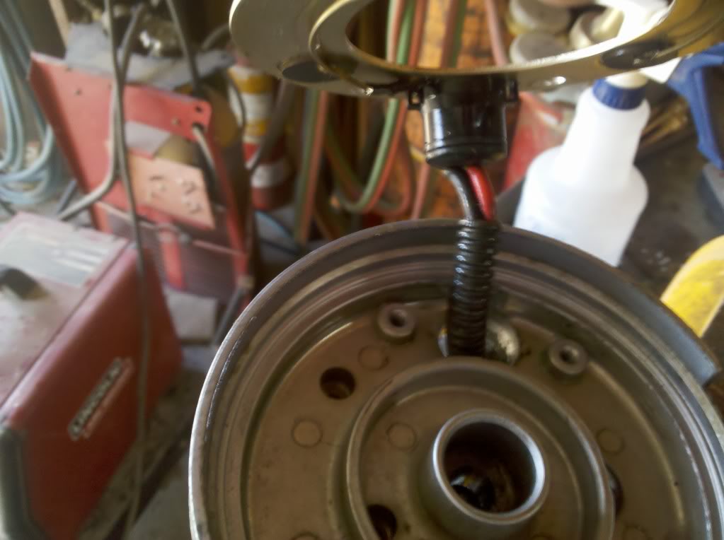

Old Jan 3, 2013 | 12:34 AM
drolex's Avatar
Posts: 257
I tried getting the wires out of the plug like the guy above, but it was too difficult. I wouldn't bother attempting that. Here is a picture of what I did. I cut the wires, installed the new o-ring, crimped these connectors onto the wires, put heat-shrink tubing on the wires, connected the wires, then shrank the tubing with a heat gun. Note that I cut the wires at different places so the metal connectors won't touch even if there is no insulating tube. I think the wire and connectors are about 10 AWG, and the heat-shrink tube is 7 mm (you could use 6 mm).
I can cut of the heat-shrink tube and disconnect/reconnect the wires easily if I ever need to again. The new o-ring seems to have fixed the leak.
Unplugging the big plastic connector was a bit of a challenge for me. I just snipped that plastic mounting piece off so I could move the plug and get a better view and grip on it. I zip-tied it back up when done.
