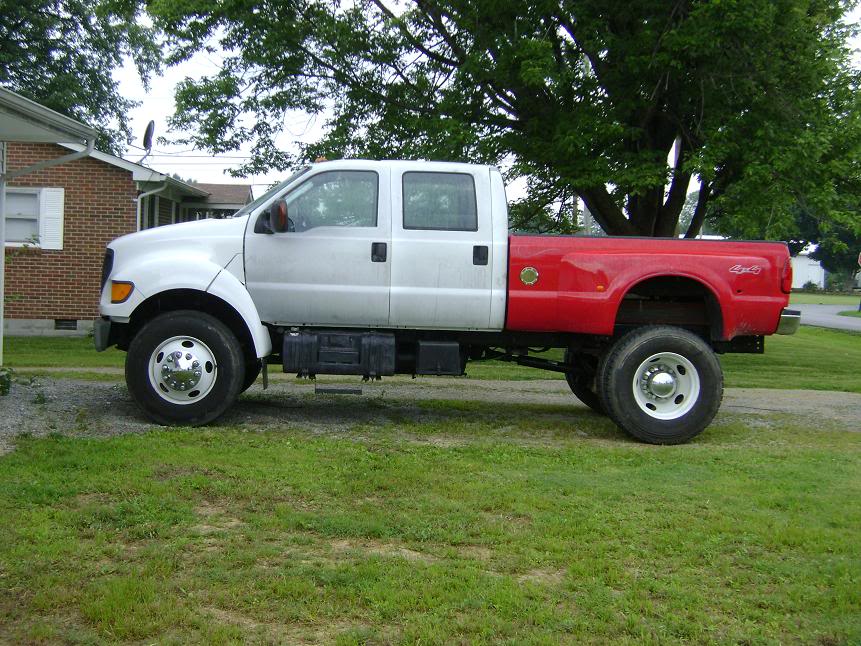

I turned this truck into a pickup truck.....put a dually bed on it. This is just a play toy that I drive around.
The truck has a 6 speed
Here is a pic just after I shortened the frame and added the bed back in July '11: Name:  supertruck43.jpg
