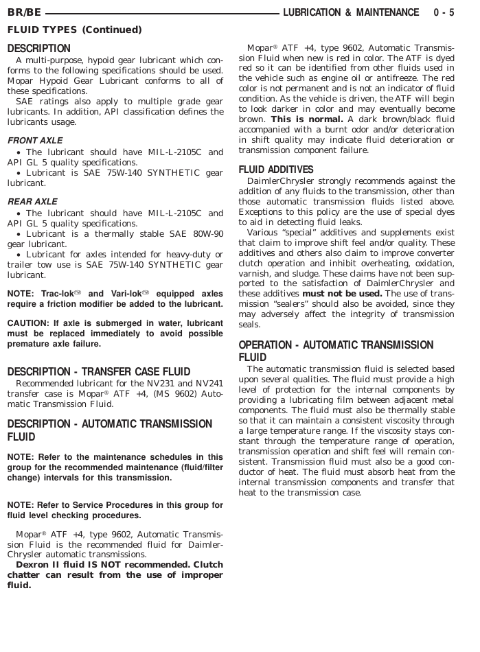

Thanks Alpine! I'm not going to use synthetic lube.
In the manual I saw 80w90, but I saw a few old threads where they were using 75w140. That has me a little perplexed! You wouldn't happen to know a ballpark figure on how many quarts I might need would you? Thanks!

If you want to go 75W140 for heavy duty use - go synthetic.(As you see above)
A lot of standard gear oils do already contain friction modifier.
The axle type is on the build sheet sticker under the hood. Or you can ask your dealer to print it for you.

Thank You Very Much Alpine! I bought the 80-90w, but maybe I'll take it back and get the 75-140w. We do haul a livestock trailer with it!
Thanks for posting the capacities!
