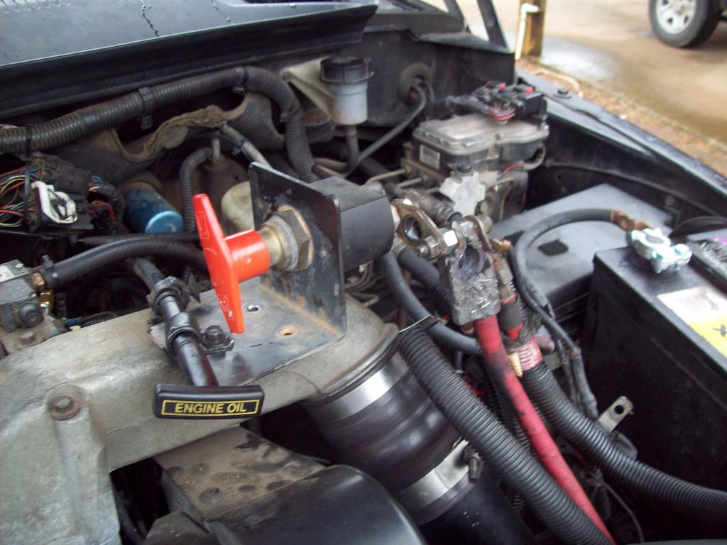

I put a battery disconnect switch on for now ... Gona move it to the bed of my truck so I want have to raise the hood to turn it off & on ... Same as disconnecting the battery cables to re set ECM ... Its a cheep fix but it works ... code po602-001.jpg

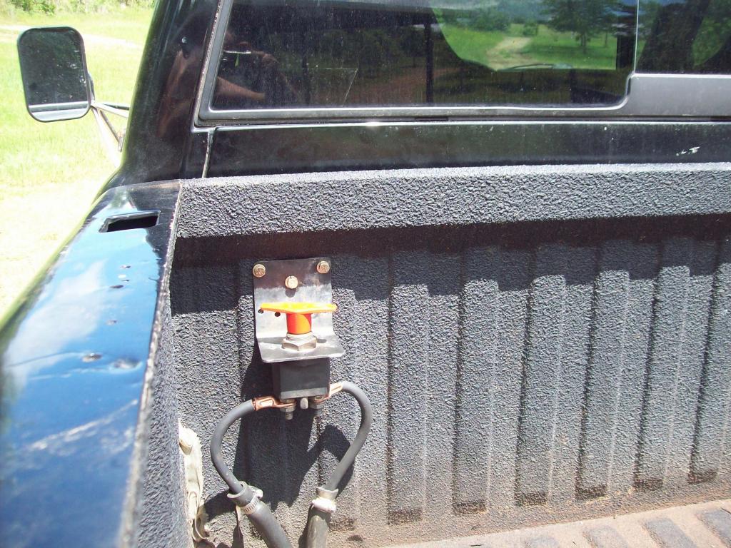

Moved the battery disconnect switch to the bed of my truck ... Now my batterys don't drain down and its ready to go when I am ... Kiss my butt you dang ECM ...
