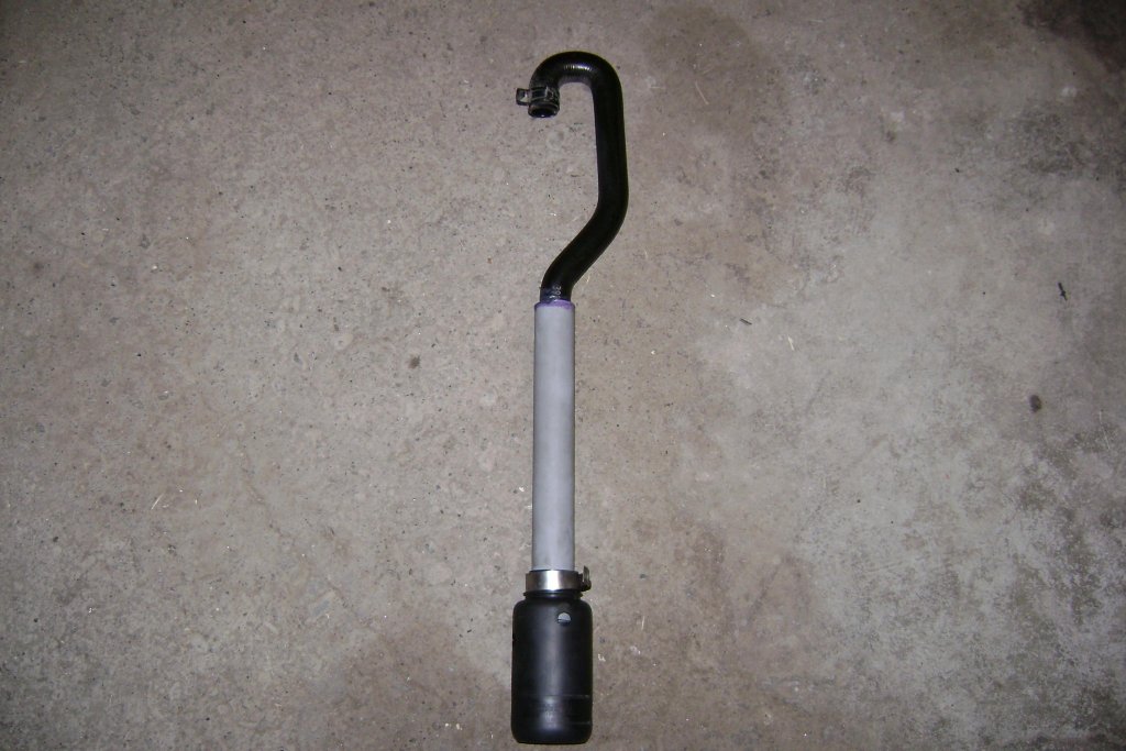

Old Apr 23, 2009 | 09:53 AM
  #45
wantedwolf's Avatar
Joined: Mar 2009
Posts: 71
1" pvc fit in the bottle great. it took 10" length and 10 mins.
https://www.dieseltruckresource.com/...4&d=1239855221
