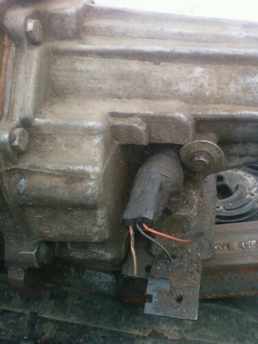

I am doing the swap on the 29th and I already have everything to do it. Really, the only question I have on this is the speedometer. Since this tranny is out of a 12 valve, does that mean the speedo has to be mechanical? I just noticed this harness and I was wondering if maybe it was the speedometer.. T

Your speedo pickup is in the rear diff. Forget about the sensor on the side of the tranny.
Ok thanks a bunch.
