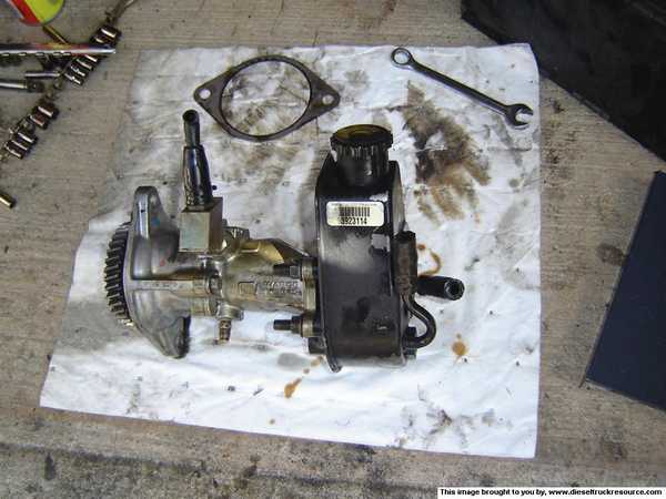

I too thought it was my PS pump. It is actually the vacuum pump. Click here.
The leak is actually engine oil getting past the bad seal in the vacuum pump. I recently did the repair on mine and it was a breeze. Click here for a short write up I did with a couple of pics.

The vacuum pump is on the drivers side of the engine, underneath the injection pump. The power steering pump and vacuum pump are on a common shaft. Here is what to look for under the hood, the PS pump is on the right, vac pump on the left:
