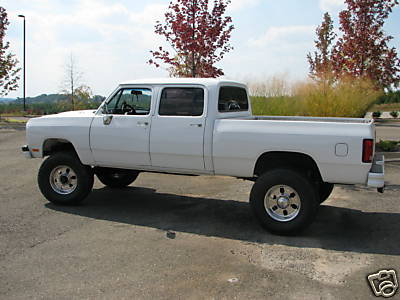

What is the cost for a zero-hour from Cummins for our 5.9s? Is it worth the money or should I try to find someone locally? I tried to sell the Crew cab but apparently God has other plans for it so, It is time to start planning for my 1980 Crew cab conversion and I need some pricing options. I want to buy an engine/auto trans/TC, rebuild them, and then install them into the Crew cab.
Trooper Thorn and BC847, I will need some guidance from you and others who have put a Cummins in a Crew cab and/or done extensive mods. Greg (I like bikes) I will need some guidance in metal fabricating and Twin Turbos. I plan on starting the project around June so I'm in info gathering mode now. I have a lot of questions such as 1st gen vs. 2nd gen engines, A518 vs. 47rh and so on.....
