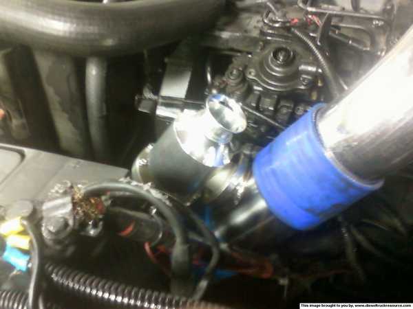

First I might start by saying i needed one for the turbo bark. I know most people say diesels dont need one because they dont have a throttle plate. but a bov on a diesel and a bov on a gas are too differnt to compare. Gas engines need them to throw the air away asap as not to break the shaft of the turbo or burn the bearings because theres absolutley no escape for the pressurised air.
Diesels need them once you start running higher boost and barking the turbos. If you do it often even though the air escapes through the engine its not fast enough for that much pressured air to escape or for my needs as its still barking the turbo.
After seeing all the electronic diesel Blow Off Valves i didnt want that stuff and it wouldnt work for me seeing as my tps is bad and i use a pot as the electronic diesel bovs run off of the tps. The price was a bit outragous also.
With my hx50 i get some pretty good bark and some other wierd noises some times and didnt want to kill my turbo. So I started researching and using previous knowledge of all the turbo gas cars ive owned and built and i got a bov for a regular gas car to work on the diesel with just the boost line, No vacuum, as its a sequential blow off valve and works off pressure spikes.
So after hours of adjusting and test running the truck I got the blow off valve adjusted to open as soon as it sees any pressure drops to regulate the pressure in the intake. It also only opens for just a second as its pressure regulated and not vaccum.
Total cost to do every thing was 110 bucks. and only fabrication tool needed was a hacksaw to cut piping.
The sound as 40psi is pretty crazy when the bov opens
Im thinking if you ran the BOV off drive pressure it may open a hair faster seeing as it would be a big fast fluctuation of air instead of a smaller one which would move the valve faster. Both would work near the same.

only thing i used was the bov, a fitting to tap into boost. and some nylon line. hardest part was adjusting the valve correctly as there isnt much adjusment on an ssqv u can do but the little adjustment there is was tricky
