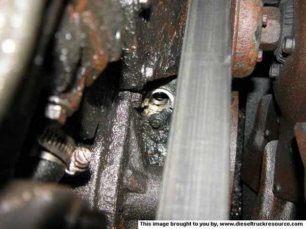

ok so i took a flashlight out there and found where the problem is! looking at the motor almost center behind the fan there is what looks like a small eyedrop shaped tab held on by one bolt (engine still fully assembled) well on this truck that tab is gone and the housing around it is cracked. the reason i ask about the price of the housing is that there is a 1st gen motor at the local salvage yard. it is intercooled while mine is not. he wants $850 without inj pump and without turbo (kicking myself, was gonna get the whole truck for $1000 2 weeks ago) i would like the 7mm head for my truck, and if i can use the case on this one blah blah blah... anyone think this might be the way to go? thanks for continued input i will try to get pictures up in a few minutes

Is that one of them KDP tap fixes? The outside the case drill and tap? If so, looks like the cover is missing, obviously. Looks like you only need to fab a cover for that hole.
It is normal to hear all weird sounds with the oil fill cap removed.

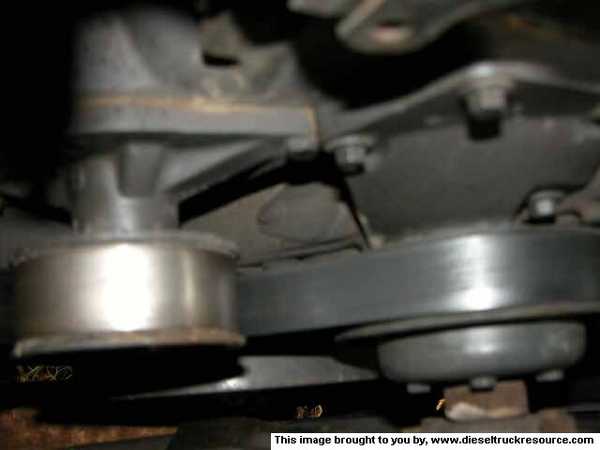

from my 91 that is hurting.....
from my 91 that is NOT hurting.....

bgilbert, the case around that hole is cracked if you cannot see it. unless the upper part of the hole is supposed to wiggle when the cap is off?

Mark, I don't remember ever seeing a cover plate like that on any truck I've worked on - but I haven't worked on many non-intercooleds.
It sure looks to me like the KDP or one of the case bolts has worked loose and dropped in the gears.

dave, i looked at the intercooled motor at the salvage yard and there was not such cover plate. i'm sure my wife's truck looks the same. it looks like somewhere that you would insert a tool to turn the motor. the piece that is broken on the case pivot on the bolt that is holding it. if i remove the case cover and other things in the way, would it be possible to repair this part? my first though was jb weld or something like that. the broken part is aluminum and the brake seem to be clean from what i can see. i will try to get it apart and take some better picture tomorrow. if it is not repairable what does the new case cost? and what has to be removed to replace it? thanks guys!

It could be TIG welded. I think a new case is in the $400 range. Everything that's bolted to the case (IP, vac. pump, etc.) comes off, and you have to either pull the cam or the cam gear. If you pull the cam gear, you need to be able to heat it up to 450 degrees or so to get it back on.

I bought a new cover from Cummins last year for $400, same price as the oil pan.
