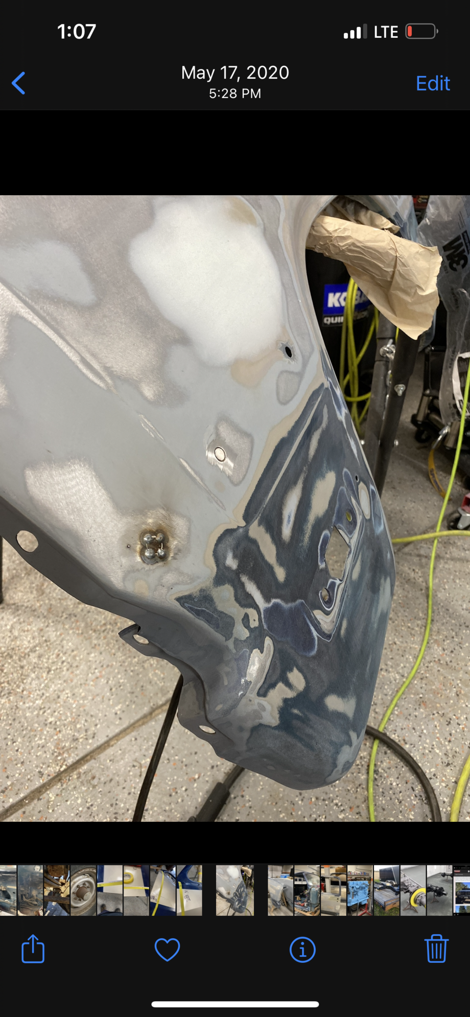

On my 1992 LE trim truck the very front part of the fender and the on the cab corners had “bolt on” trim. This was the same for my 1991 LE parts truck.
The trim for cab corner and the very front of the fenders had 1/2” holes for a stud on the trim to pass through then you used a speed nut to attach it. I’ve seen post of people putting marker light an all sorts of creative solution’s to plug up the holes. All the long straight sections are 3M taped on. Then there are some small holes to locate the fender trim too. I plan to keep my fender trim.
the aftermarket does not offer these “molded” trim pieces for the cab or fender. So I recommend shaving/filling them if you are going to repaint the truck. Cause all the new stuff will get taped on anyway.
this will only apply 1991-1993 LE trucks.
included is a pic of me filling my fender trim holes on a 1992 LE truck.

I had never thought about eliminating the side trim and wheel arches but after looking at the comments and photos that idea is fast moving up the consideration ladder. Probably another day and a half before it pops up to the top.
