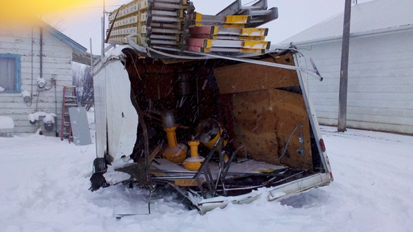

The difference is this:
An inertia controller has 2 inputs. It senses the brake light switch, indicating the pedal is away from the top stop. It senses the deceleration of the tow vehicle. With these two inputs it tries to guess how much braking to apply to the trailer.
1. Incline, headwind, and road condition, abs cycling and brake condition all effect the pendulum sensor.
2. Most will lightly apply the brakes before any deceleration is sensed. That's fine on dry road, but gets inconvenient to deadly on ice or with an unloaded light trailer.
A controller that runs on hydraulic (or air) pressure matches the trailer brakes to what's happening in the cockpit. In tough conditions, the moxy of an experience driver trumps relatively primitive electronics any day.
This is the result of an inertia controller's "guess" on ice. Premature light application of trailer brakes (driver just touched the pedal) on ice in a crosswind put the trailer crosswise in the other lane. Pretty much wrecked the day of the oncoming driver also.

Just revisited the Montana accident with my son today. He said, as he remembers it:
1. He topped a hill, and the truck drivers started slipping.
2. He steered into it, and as he regained control, lightly hit the brakes, not even engaging them.
3. The trailer went sideways into oncoming traffic.
As I said before, the same pre-charge that makes parking an empty boat trailer, or maneuvering around a parking lot on ice a pain, locked up his trailer brakes and sent it out of control.
I do not think it wise to have a trailer brake controller that is not directly driven by the braking effort of the driver, including sensitive efforts as you would execute on ice. I am coming to the opinion that the pendulum controllers are downright dangerous, and their approval is criminal. pix of a smartbrake
