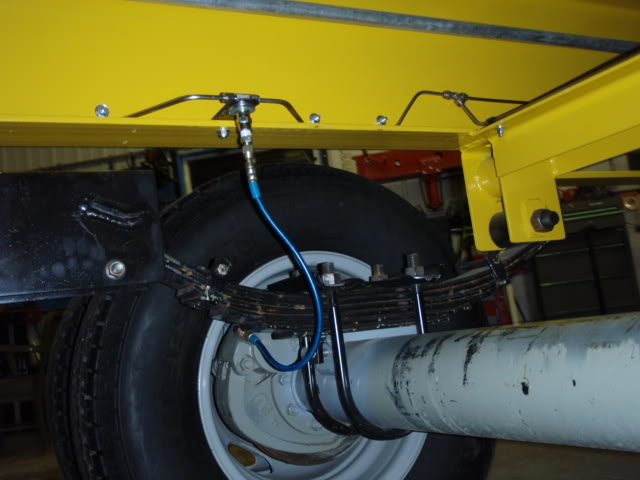

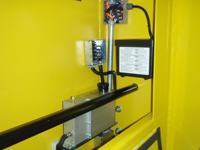

Here is a picture of the Carlisle elec/hyd actuator I have on my 42' GN:
and the 12k hd disc they stop it with:
