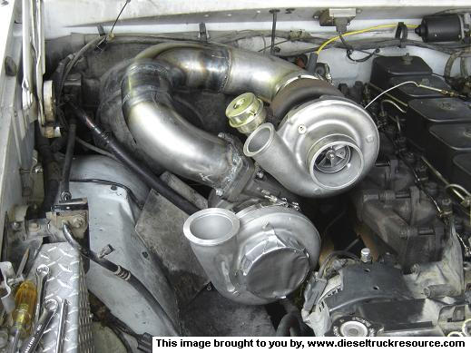

I decided that it's time to add some air to my truck so last weekend cummins2fast and myself started to fab up some twins. I just want to say I have a new found respect for people who build their own twins! It has been a fun project, but it's hard to come up with a decent design when you work in tight spaces. I know my hot pipe looks a little unconvetional, but with the way it is routed, I have all kinds of room to fab up a 5in downpipe without having to cut a hole in my floorboard. The progress is slow since weekends are the only time I can fit the project in my schedule, but they should be done soon.

lookin gooooood!!!! i am definitely interested in progress reports. and what's this about cutting a whole in the floor? never heard of that. what kinda turbos are those? b1/b2? anyway, have fun!

Good eye! You have guessed one of the turbos correctly. I also want to say thanks for answering some of my dumber questions. I'll post more pictures as we get the cold pipe welded. I cant wait to go for a ride and see how these turbos respond with each other. I'm expecting them to be a little laggy on the bottom end, but they should hit hard.

Now thats just SWEEEEET! If only I could weld and fab . Keep up the great work.

Here is a side view of the turbos and hot pipe.

I think that you have the right idea there... That's the best set-up style that I think I've ever seen.
What are you pushing fuel-wise?
