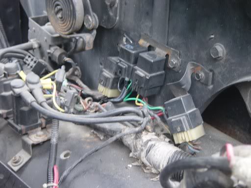

How to use a relay to controll the netural safety circuit!!
On the starter relay. The power feed for the coil section is the yellow wire. The two small brown wires are the ground circuits. One wire goes to the PCM. The other goes to the netural switch on the auto trans or under the dash for the manual setup.
Tap into eather one of the two small brown wires. Do not cut the wire, just tap it. Take that tap to terminal 30 on a 5 pin relay. Run another wire from terminal 87A to a ground.
Find a switched power feed. Make sure the power feed is dead when in the start position, live in run position. Run this power feed to terminal 85. Run a wire from terminal 86 to a ground.
Terminal 87A is a normaly closed circuit when the relay controll circuit does not have power. So that means in the start position the netural circuit is closed. When the relay is powered up in the run position. The relay switches the circuit flow from terminal 87A to terminal 87. Terminal 87A is now open circuit. The PCM wants an open circuit to allow cruise controll function.
BTW I used the windshield wiper power feed for the relay controll power. The wipers are not powered in start position.
Here is a pic of the relay install.
A note of warning now. With the netural circuit rigged with a relay. The only way to drop out of cruise controll is by tapping the brake pedal or turn it off with the switch on the steering wheel. The orginal clutch switch would drop CC when you pushed the clutch in.
