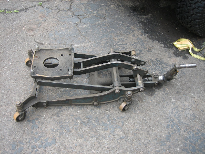

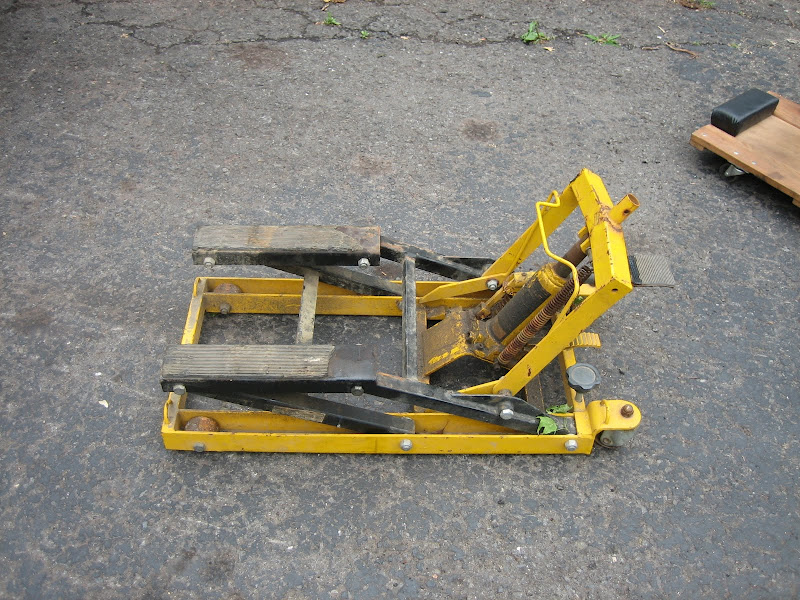

Initially I borrowed this jack:
It fit under there, but wasn't exactly the perfect tool for the job.
Then someone lent me this jobber:
Still not perfect for the job, but a lot better. It's funny...it has those big bolts to even the load, should the bottom of the tranny be out of level. They go around the Getrag...it's just too small.

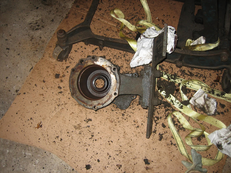

One of the users here (and I believe a mod on one of the other forums) recommended this place for new seals:
http://www.makcotransmissionparts.com/NP205.html
So, I ordered new seals...as you can see from the picture, she's a bit leaky.

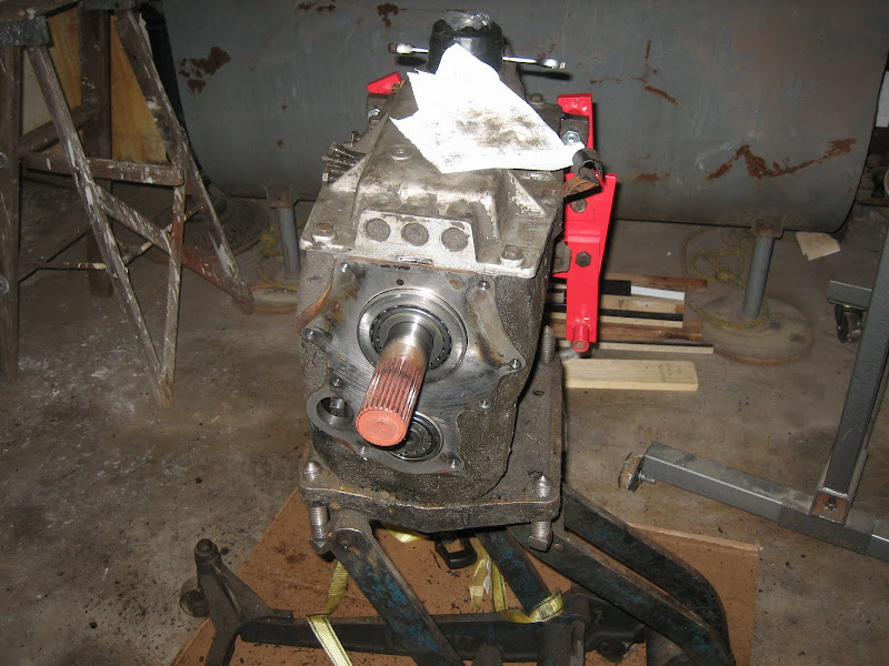

So, about then it started raining so I cleaned up the tools and moved inside. The tranny was definitely grimy from leaking, so I started popping covers to reseal with black RTV.

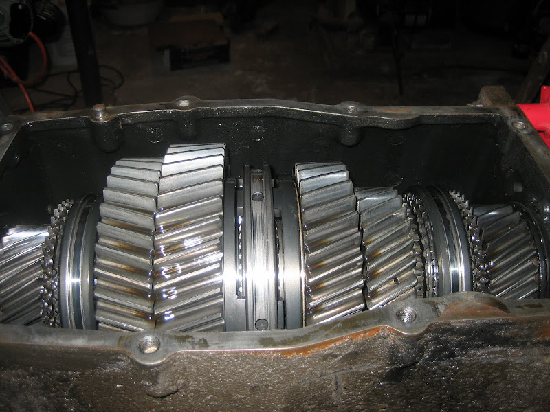

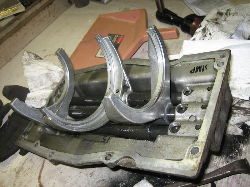

I popped off the top...
I wasn't really expecting all this stuff to be attached to it...but the forks look good to me...of course I don't really know crap, but...
The gears look good. You can see an edge worn down a little here and there, but I think it'll be fine...but again..what do I know?

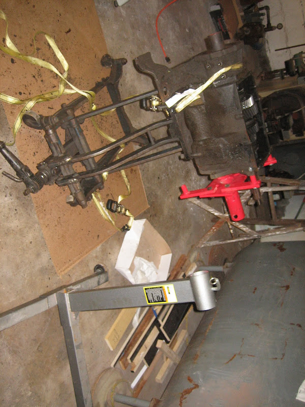

So, here's how I'm working:
The jack picked nice and high, but I couldn't for the life of me figure out how to get it up on the engine stand. Oh well, jack FTW.

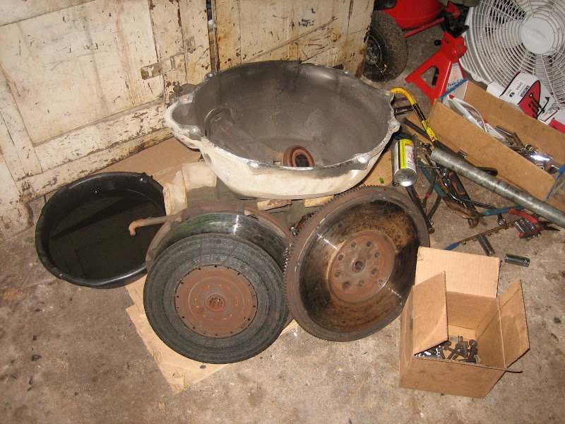

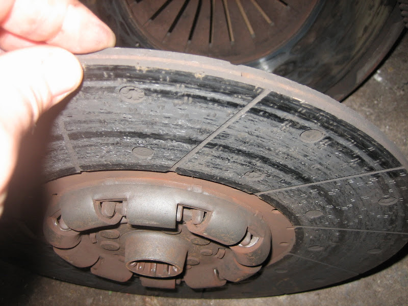

Anyway, here's my other pile of goods:
Here's a close-up of the clutch. It seems in good shape, so I was kind of planning on using it.
Anyone more experienced than I who can tell me if they'd consider it pretty beefy or worn enough to demand replacement?

That clutch is no good. Look how little material there is left, the rivets are almost through.
Looks like the factory Sachs though. Take a picture of the backside of the pressure plate, and front side too. The sachs clutch is easy to spot because the PP is super heavy looking iron.
don't forget to get the flywheel resurfaced (napa can usually do this, or a machine shop, some auto parts stores etc....) its about $40 but it's worth it to get a nice true flat flywheel!!
I would just hit up the local parts store like Advance auto and get a stock replacement 13" clutch.

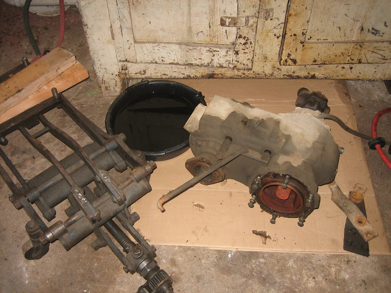

So, I took a 1/2 day today at work.
Got the flywheel resurfaced.
Picked up the clutch combo.
Ripped the transfer case off the automatic.
