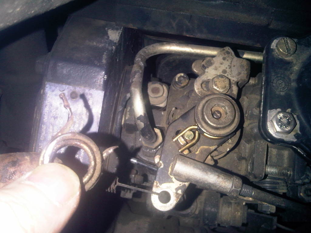

throttle spring?
Don't really know what its name is, but mine was done.

That is called the breakover spring. Sorry, don't know the p/n. I'm sure you can find it with a search.

Bosch P/N: 1 464 651 430.
