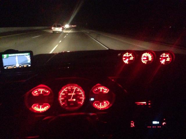

-glowshift
gauges I got for free
-red gauge cluster lights from superbrightleds, repainted needles with red model paint and polished lens

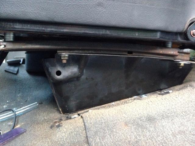

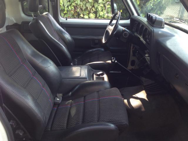

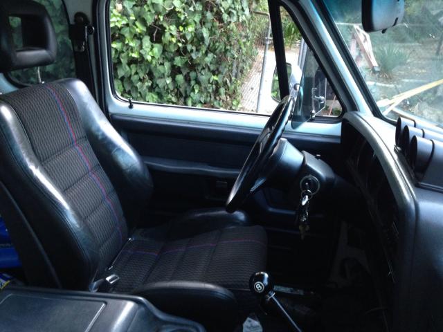

-mounted stock 1st gen center console and factory recaro seats from an Opel omega 3000gsi. Best $30 junk yard find ever. The pass seat is still awaiting mods. If you've ever sat in an SRT8 charger, challenger or 300, these are nearly identical in comfort.

Unfortunately the omega 3000gsi is a European market car, I snagged these seats during my tour in Germany. Was going to recover them and put them in my Lemans, but I was looking at them and thought about how much I hate that bench seat....
I mounted them on factory 1st gen bucket brackets and rails. Only had to drill new holes in the seat frame and slide the whole seat 1" to the passenger side.

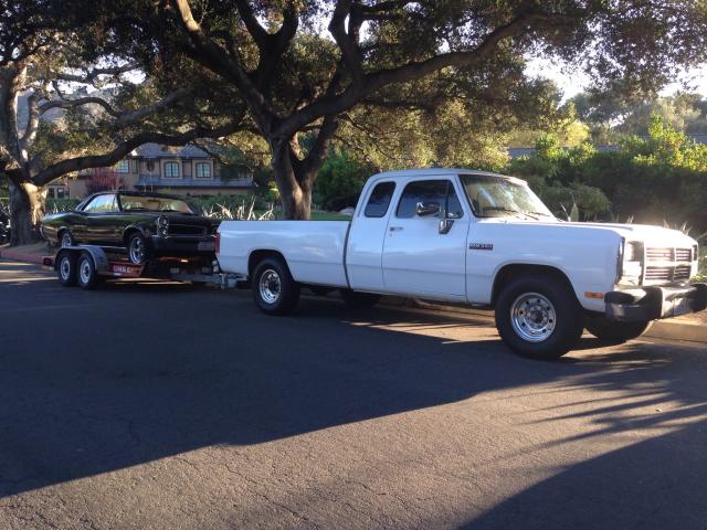

And some pics of her towing some of my other cars.

-glowshift
gauges I got for free-red gauge cluster lights from superbrightleds, repainted needles with red model paint and polished lens

) with an awesome cummins ram charger.And some pics of her towing some of my other cars.

JPSW250- I got the stock 1st gen buckets, console and hardware from someone parting out a cab/chassis W250 locally. However, the same setup came in Ramchargers. There is a Ramcharger at the pick and pull near me with red seats and console.

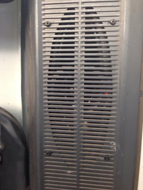

James1- the rear speaker boxes needed new mounting holes. The stock speaker uses two bolts on each end to secure the speaker. I drilled the 4 new holes and used the supplied hardware that came with the speaker. The small heads on them don't stick out much. The stock boxes are not sealed and are flimsy, so I double layered peel and seal (budget sound insulation- Home Depot) on the interior of the speaker box and used some universal weather stripping I had laying around to provide a box to cab seal. The speakers have a built in 7/16" spacer so they can be mounted flush behind the speaker grille without risk of woofer contact. The sound is incredible, and all done with low budget parts. The kenwood speakers provide excellent mids and highs, with decent lows. I am very satisfied. The part number I used was KFC-415C, $54.99 shipped from the auction site new.
