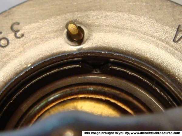

I don't know if you can see it in this picture too well, but there is a little notch in the Cummins T-stat that lets it "leak" as it starts to open, so the flow is modulated at the cracking temperature quite differently from the usual t-stat. I also read somewhere that the head pressure on the t-stat in the B engine is much higher than usual designs, so an inappropriate t-stat can't overcome the pressure to open, until it is quite over temp.
