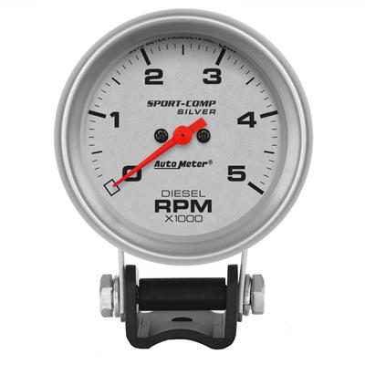

Old Oct 24, 2005 | 07:16 PM
wannadiesel's Avatar
Posts: 22,594
From: New Holland, PA
Like this?
That's Autometer 3788.
Old Oct 24, 2005 | 07:42 PM
Underpsi's Avatar
Posts: 1,125
From: Ontario, Canada
that ones pretty good looking, didn't think they made one like that, i could prob get the blue lights for it too, thanks for posting that, i wonder if u can get chrome bezels for it
