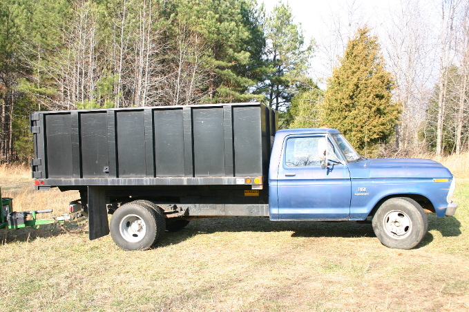

I have a 1974 F-350 dually with less than 100K original miles on it, that has a 12'x8'x 3' dump body on it. The dump body is self-contained, in that it has the hydraulic tank and electric pump mounted in the dump body frame. The guy who owned this truck before me had the dump body installed on this truck, from an original flatbed. The cab needs paint but has almost no rust in it.
It has a 360" gasser in it which runs like a top, but as you know, has no torque, mated to a granny 4 speed. It sucks when you have it loaded up.

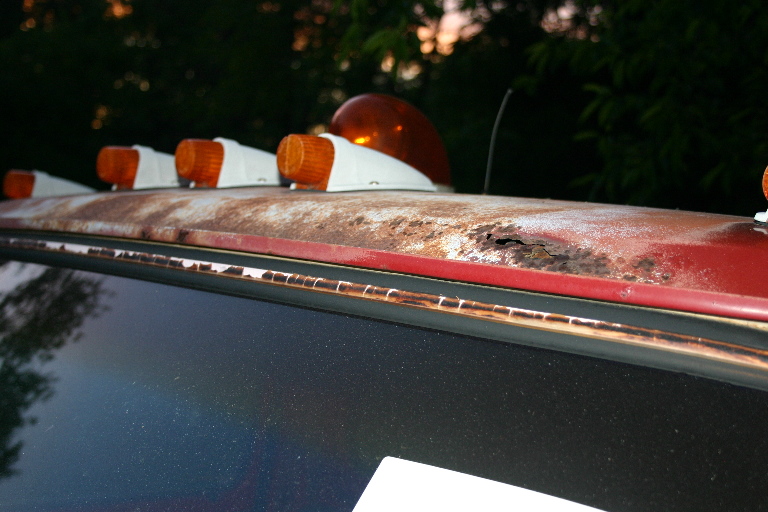

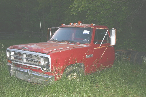

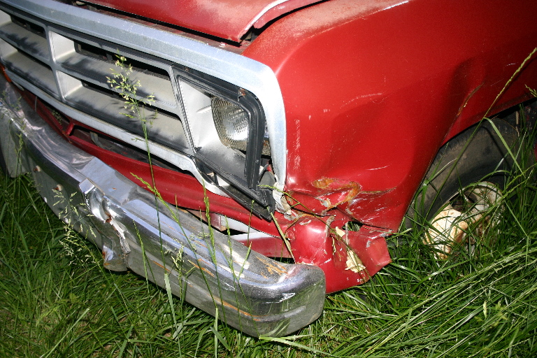

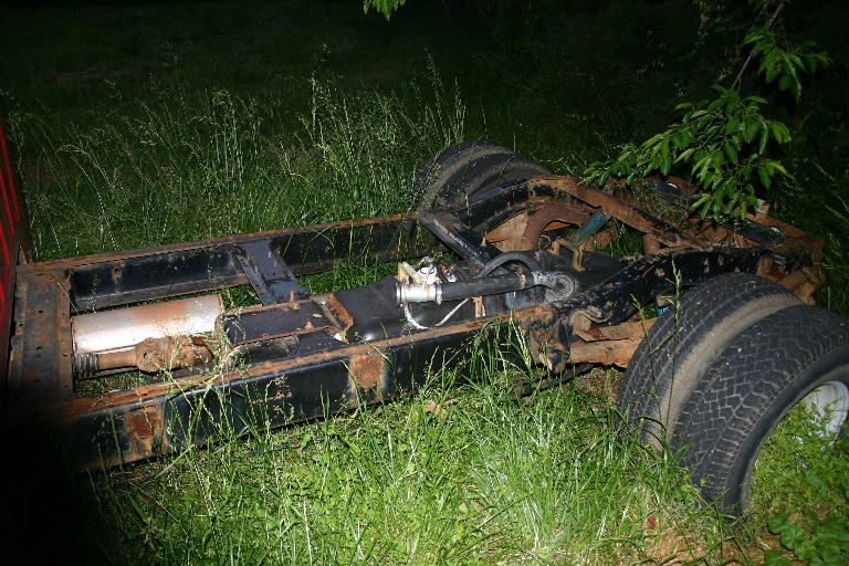

I bought a 1989 D350 dually cab-N-chassis that has a 12 valve and a 5 speed. The cab on the 89 is pretty bad. It needs a fender, grill, other front end body parts. The driver's door will not latch, and I have never looked closely at it to figure out why. The cab has little rust holes in the roof between the windshield and marker lights. I suspect that this truck had a dump body on it also, but it was removed before it was sold. The engine runs fine but I have not been able to drive it much since it has no license on it. Just driving around the yard and such.

Where did you get the Ford ??; that looks just like the neighbors truck that he used to pull a chipper and haul the chips in.
