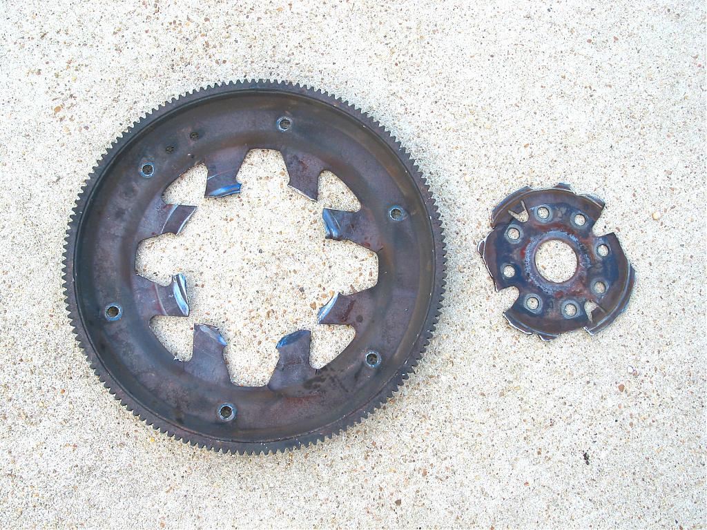

I dunno on this one. It would seem to me that, with the factory torque converter and stock engine, you wouldn't have enough power to rip out the flex plate. But....
Before mine crashed, I did hear funny sounds on accelerating. I'd call them a pinging sort of sound, like a gasser pre-detonating. Then, accelerating uphill from a red light, there was a terrible grinding noise and the engine revved without power to the rear end.
So we had a wonderful week in downtown Magee, Mississippi, but the folks there did get it back up as soon as the part (second-gen flexplate) arrived.
I'm with BC847; find something big and try to trace it before you go to the big bother of separating the engine and trans to look at it. BUT - if you want to, and have the time and equipment, this would be the perfect time to replace the stock flexplate with the upgraded second-gen one. Then you'll know one way or the other.

Early and late versions?
I have two engines that are both out of 1990 trucks with engine build dates of late 1989. The flexplates on both of these engines are different than the ones pictured for 1993. Is this early design without the holes better than the 1993 models or is it also subject to the same cracking failures?
