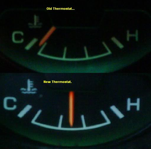

I changed the coolant last night and it still won’t warm up to normal operating temps. It is starting to get cold up here -15C or (5F), it will eventually plummet to -40C (-40F). Do these engines not warm up in the winter?? Could it be my thermostat? See attached photo of my temp gauge, this is the warmest I could get it after driving on the highway with a cover on the front grill.

That's pretty low for operating temp, but your volts are way low too so I wonder if the gauges are all reading below real value. Is your oil pressure showing above half after warm-up?

For the warm up problem mine did the same thing. my t-stat was stuck open. For the other problem i think i found an in frame rebiuld kit but i dont recall the site. good luck

I had my ground from my battery to the radiator support break and the gauges read all wrong untill I fixed it. Make sure your GROUNDS from your battery are all good before tearing into the motor. Just my two cents.

I changed the thermostat and wow what a big difference. I have heat!!!
