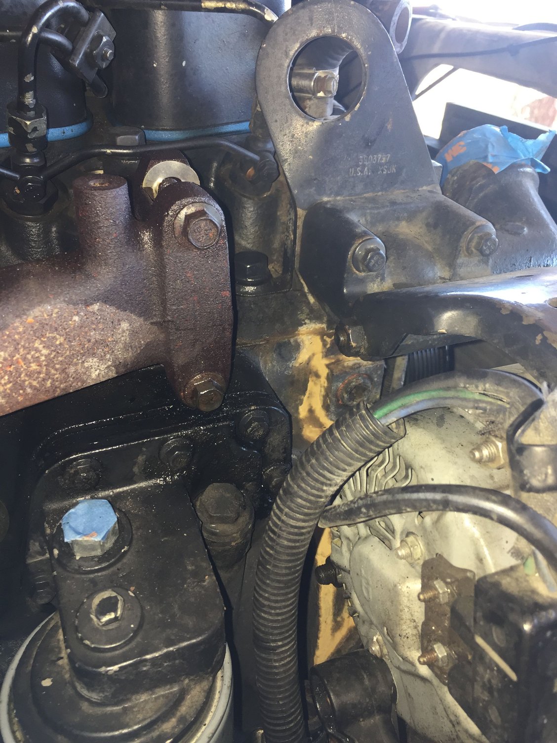

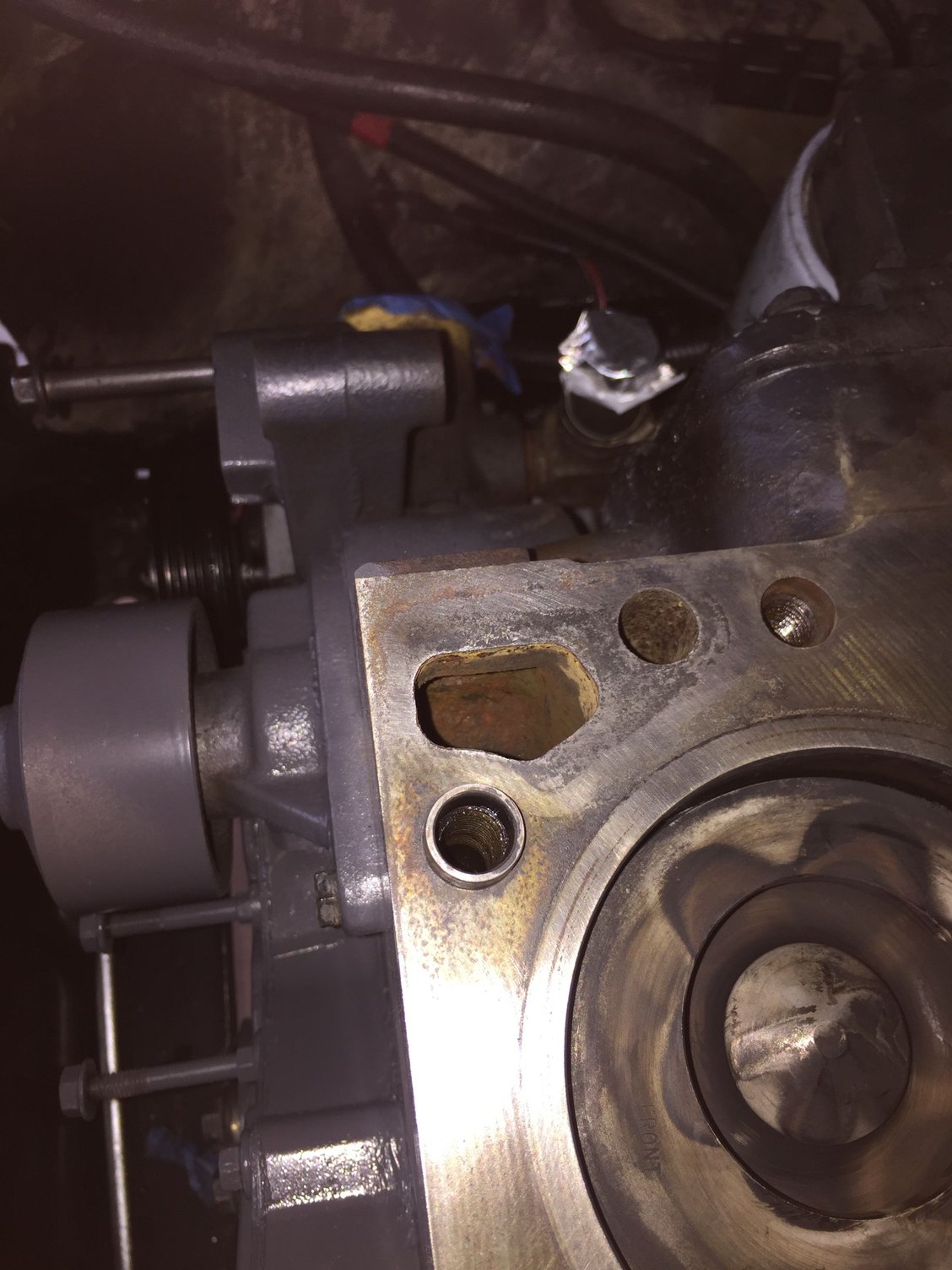

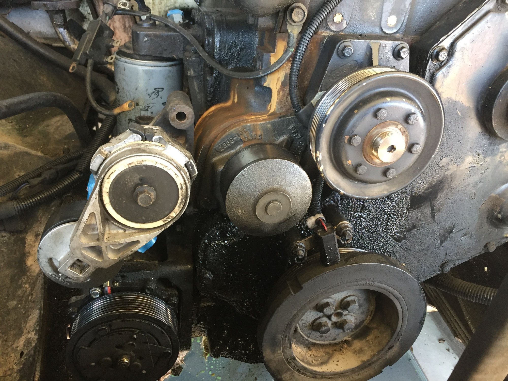

Hey guys,
Thanks for all of the advice on this issue. I finally found some time to work on the truck, and here is what I found.
I went ahead and removed the thermostat housing assembly. Once removed, I used some fine emery cloth to polish up the mating surfaces to a shiny finish. While I was in there, I installed a new Cummins thermostat, and new gasket. I opted to put a light coat of Blue RTV on the mating surfaces. Once complete, I bolted it all back together, and allowed the truck to sit for 24 hours before filling it with coolant (per RTV package guidelines). So, I filled it with coolant, and went hunting. When I arrived at my hunting spot, there was coolant all over the differential. It didn't look like any was coming from underneath the thermostat housing, but rather from the water pump.
So, off to the parts store. I picked up a new water pump (gates brand) and installed it on the truck. I burped the system again, and took the truck to Fort Collins (about 80 miles from me). When I got there, I had coolant splattered everywhere. ****. I filled the radiator once again before my drive home. Well, on my drive from Fort Collins back to Laramie, the truck didn't leak a drop. In fact, it didn't leak again for another couple of weeks.
Fast Forward a couple of weeks to Thanksgiving. The truck sat at my place for a week while I was in Mexico for vacation. When I got back, I fired her up, and drove the 80 miles home. Upon arriving home, I noticed coolant all over the differential, yet again. This time, it was pooling directly under the thermostat housing.
So, am I missing something stupid, or does this sound like a head gasket issue? I should add that I also replaced the radiator cap while I was in there.
Thanks in advance for all of the help!
Jake

Jake,
Check your coolant hoses, around the clamps for leaks.
I changed out all of my coolant rubber last year and tightened the clamp to tight and cut thru the rubber on one of the front heater coolant lines. Chased the leak for weeks, it would spew coolant some of the time but not all the time. I found the leak only by chance when I rested my hand on the warm hose, it opened the cut enough to show the leak.

It's your head gasket. These engines are notorious for leaking there. Stop driving it (if you can) until you can address it. If not, the mating surfaces on the block and head could corrode to the point that they would need to be machined.
-Niemand
