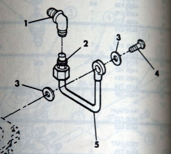

Old Sep 29, 2007 | 01:08 PM
BC847's Avatar
1st Generation Admin
Posts: 4,601
Likes: 118
From: Buies Creek, NC
P/N 2 ~ 4429 391 SEAL, Grommet.
P/N 3 ~ 4429 728 WASHER, Sealing (2 req).
P/N 4 ~ 4429 729 SCREW, Banjo Connector.
P/N 5 ~ 4429 106 TUBE, Air Fuel Control.
Hope this helps.

Now that I am quasi expert on the subject , It carries boost pressure so all the connections should be tight and sealed, if you are leaking boost, than you should notice a power increase, mine was broken off at the banjo on the housing, so I had to make my repair, if the intake side is just loose than tightening it should be fine. the line attaches to the intake elbow with a rubber compression fitting, if that is whats loose that should fix it. I geuss the factory "U" line is prone to failure, probably due to differences in vibration between the pump and block. Hope this helps, I just learned about this last week , you can see the exploded view of the factory unit in BC 847's reply to this thread.
