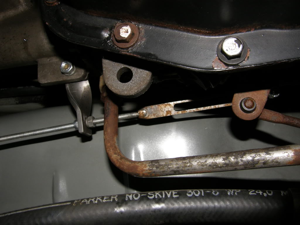

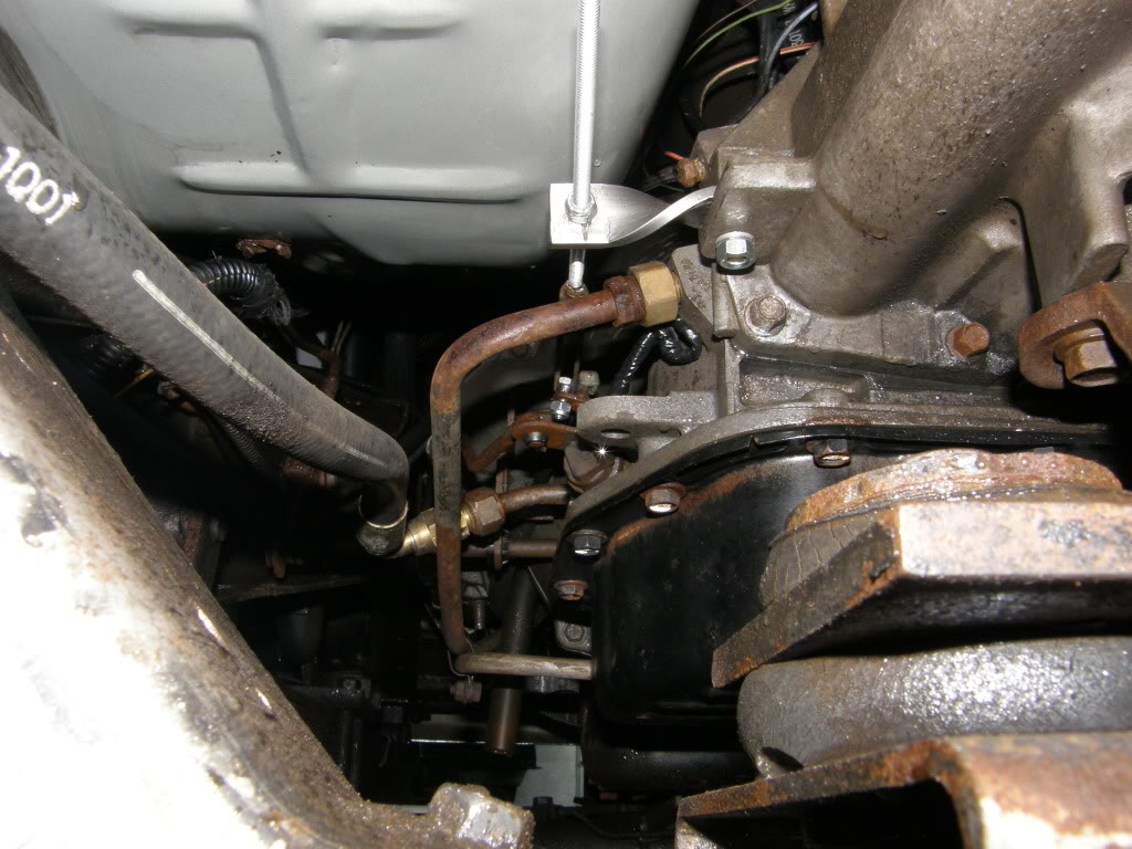

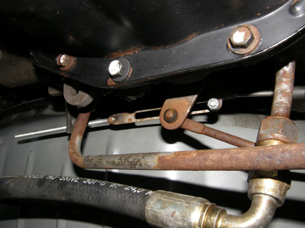

Sorry it took so long, went out this morning and got sidetracked.

JustRamIt91's Avatar
Joined: Oct 2009
Posts: 1,830
Ok so let me try and understand this. That is a limiter setup?? It holds the cable at a certain tension?position?
thanks for the pictures!
Old Jul 4, 2010 | 07:45 AM
  #40
1STGENFARMBOY's Avatar
Posts: 1,134
Likes: 139
From: extreem southern ILL
Yes, and the slot lets it go on back when needed, and the allthread and bracket lets you fine tune it to where you want it, not shure it's the best way but it works for me.

thanks for the pictures. Now i just have to find a slotted piece like that.
Are you able to achieve WOT and reach full T.V. cable travel at the same time with it setup like that?
