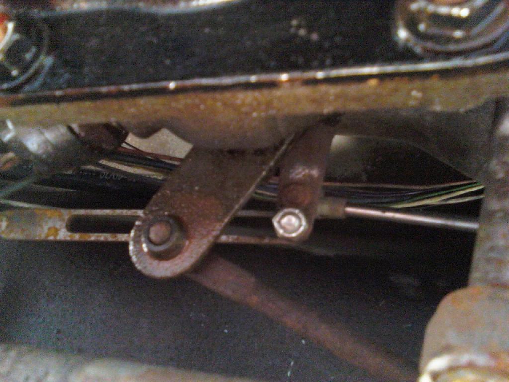

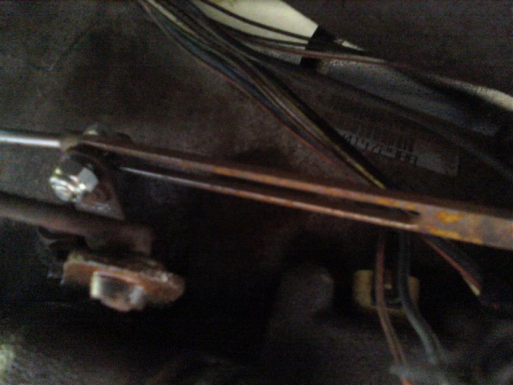

Thats what i want to do is a manual, but to hold me over i made a long sloted adjustable rod and installed it on the trany where the tv cable goes, i can adjust where it shifts, (BUT) it also down shifts there to so when your stoping it's kinda like your pulling the shifter down to early. don't know if it hurts the trany or not, it shifts 1 to 2 at 19mph 2 to 3 30mph and overdrive is according to how much your pushin it, if you hold it in the carpet it won't go into O/D till you let up alittle.
