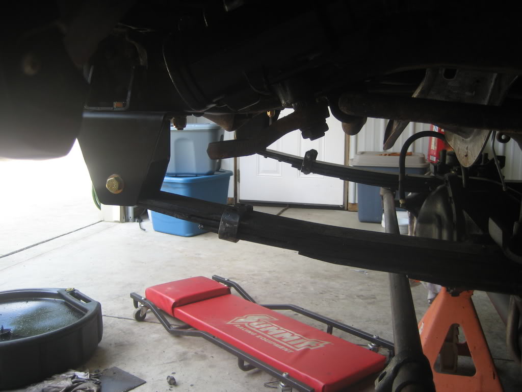

Here is the pics of mine...
Mine give 8" in the back or whatever I decide!!

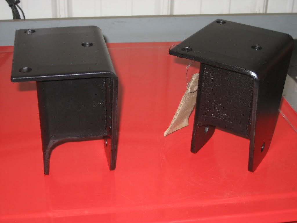

Here are the front drop ones. 2.5"-3"

I would feel comfortable staying at the 3.5" drop over stock. Here is a few pics of a set of 3.5" ones I just did not to long ago.

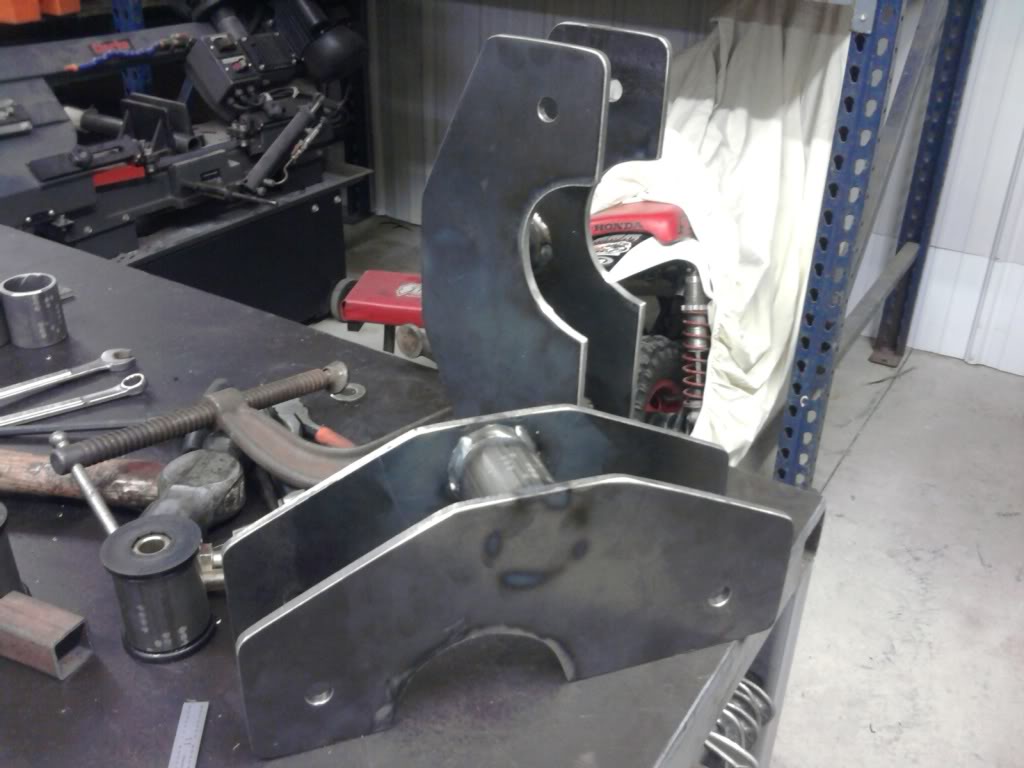

Off topic, but some cool ladder bar brackets I just made for a guy in Fl
