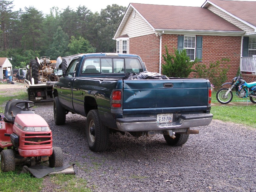

Would running belt driven hydraulics being sufficient enough to host the cylinders on the rollback and it's winch? I have a built 727 from a ton truck (don't remember if it has a PTO port)...Would the 4 speed bolt to the Cummings? I guess ultimately the 5 speed would be the way to go. Maybe I'll drive the '93 in the meantime...'till I figure out and gather what I need to put the Cummins in the rollback.
The rollback is a ton truck that has a 17 ft bed that tilts (or dump) and slides back to the ground. It's basically a flat bed tow truck...but much more versatile in that I can haul lumber, scrap, gravel...not to mention cars and trucks. You can see it in front of my '95 v10 in this picture.
