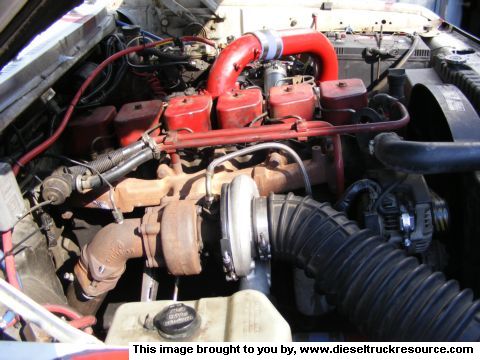

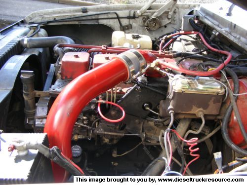

to make mine fit i changed the tanks around to fit it past the radiator with out cutting the mounts. i moved the latch over to clear the intercooler. its only 1.5" below the core support. and i made my own 3 inch pipes.

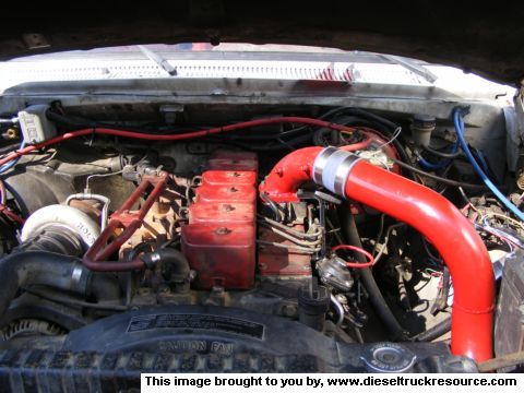

if i didn't know better i'd think i knew what i was doing

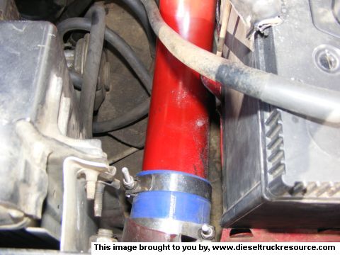

close but cutting the batt. box made some room
