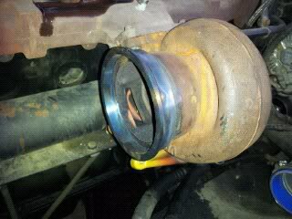

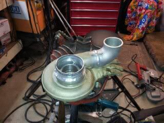

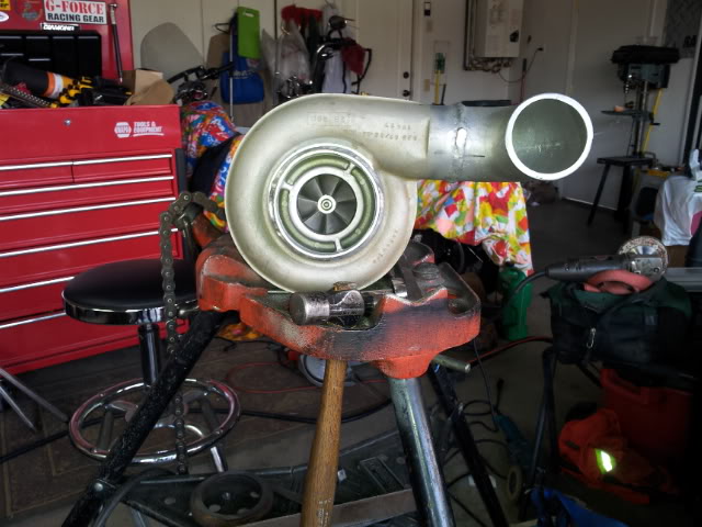

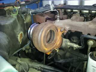

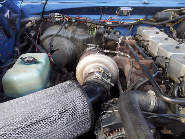

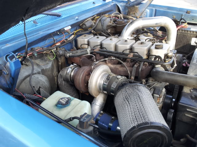

The s200 (s2bg to be exact) finally found its way onto the truck. So far I like it. Made a spring type gate actuator for it and its putting out 35psi right now with more adjustment available. Specs are 60/60/14, with a nice 10 blade turbine. Truck feels much more "open", like its breathing well. Spools a little bit slower than the hx35 that it replaced, but not bad at all. The 35 will find its way into a set of twins eventaully, they are great little turbos after all.

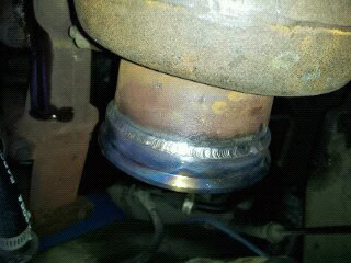

Some modifications were needed to make it all fit. Welded on a 4"inlet as the factory inlet was 4.5", an aluminum 90* for the outlet which was a straight slip fit, new 4" outlet to avoid using the marmon flange and save space, and a new flange on the down pipe. I also removed the factory wastegate cover and ported the gate and welded the cover shut after modifying it for more gate travel. This is a CAT turbine housing as well.

That's the best part, the charger was free along with the 14cm housing, also have a 12cm for it. The v band flanges,clamp, and aluminium 90 ran me around $90,plus my time.

I'd say you could squeeze some good power out of it. I think it would do 350~400 (MAYBE) but not confident it would cool all that well at that level. Also, this is a non ett compressor, I do have a sweet 58mm ett compressor in the garage ( out of an s200 as well) and another turbine wheel if I ever wanted to build another. I have found the 58 ett/60/14 charger rebuilt on ebay for $500, off a CAT. They are commonly overlooked in favor of the "superior" s300g.
