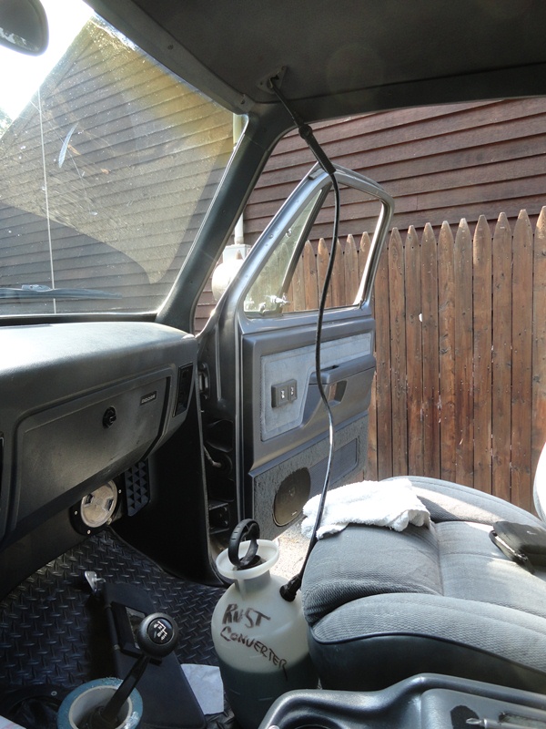

Today, I did something I wasn't looking forwards to, but it went well otherwise.
Being I had a 93 with a rotted roof, I didn't want my 92 to follow suit.... or not that soon anyway. Since it's spent most of it's existence in a salt free environment, then it was sold to me, the least I could do was to help prevent some of the salt air I live in, and the road salt from getting to the old pig...
I removed the passenger side sunshade, and used it's hole as an access to "rust resist" from inside. Notice, I didn't say rust proof, as I don't believe it's possible.... but ....
So I put the truck on a slight incline, and sprayed away. One thing I never expected was the amount of spray to wind up on the floor of the truck. It found its way all the way down into the footwell as I guess there is a pathway for it to follow down the pillar on both sides. Since it was on a hill, the fluid rolled where I wanted it to.... down the inner roofline to the drivers side from the passenger side hole I accessed, and out onto the floor. I then turned the truck around and let it roll into the other side through the same access holes cover the entire perimeter of the roof. here's it in action..
After about a quart or so of the fluid leaked out, I did the rear sector by removing the cab's cargo light and pumped it in as well. It too rolled out the drivers side (pitch of the truck) but I never expected it to come out just above my speaker in the rear of the cab. What a PITA that was. After sticking a bunch of rags into the gap above the speaker, I was eventually able to contain it.
Phosphoric Acid is STINKY and burns like hell. Don't do this without being prepared ....
After it sits overnight, it will be neutralized naturally by the moisture in the air. Anything it touched with rust on it's surface, will be now a black oxide.... and much more resistant to rusting..... for the next several years, anyway.
While I had the stuff out, I removed both taillamps and sprayed inside the body cavity above each rear tire, inside both front fenders, and behind the body in the bed in front of the rear tires.
Hoping this puts it to rest for a while...
