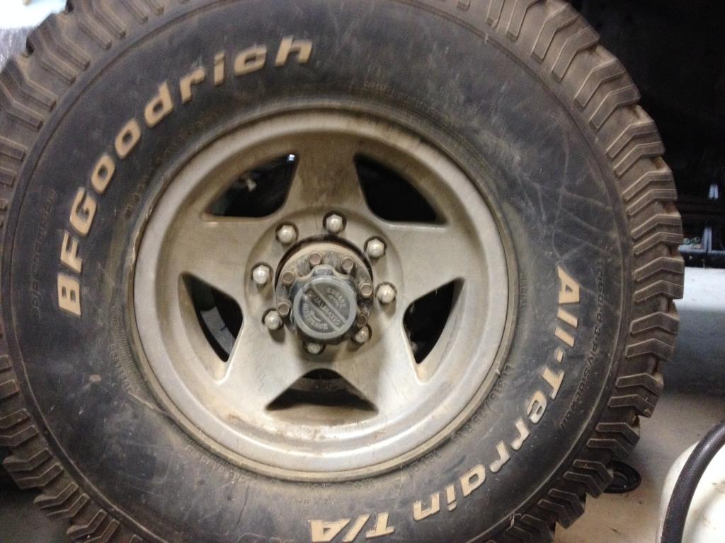

Got all excited that I was getting free wheels for my power wagon, mine look a little different then the ones in the recall. Can't find a part number either just always assumed they were Alcoa's

I'm sure you could still take those free ones in to an Alcoa distributor with a printout of the recall, and get a set of brand new shiny alcoa classics. Not a bad deal nonetheless.

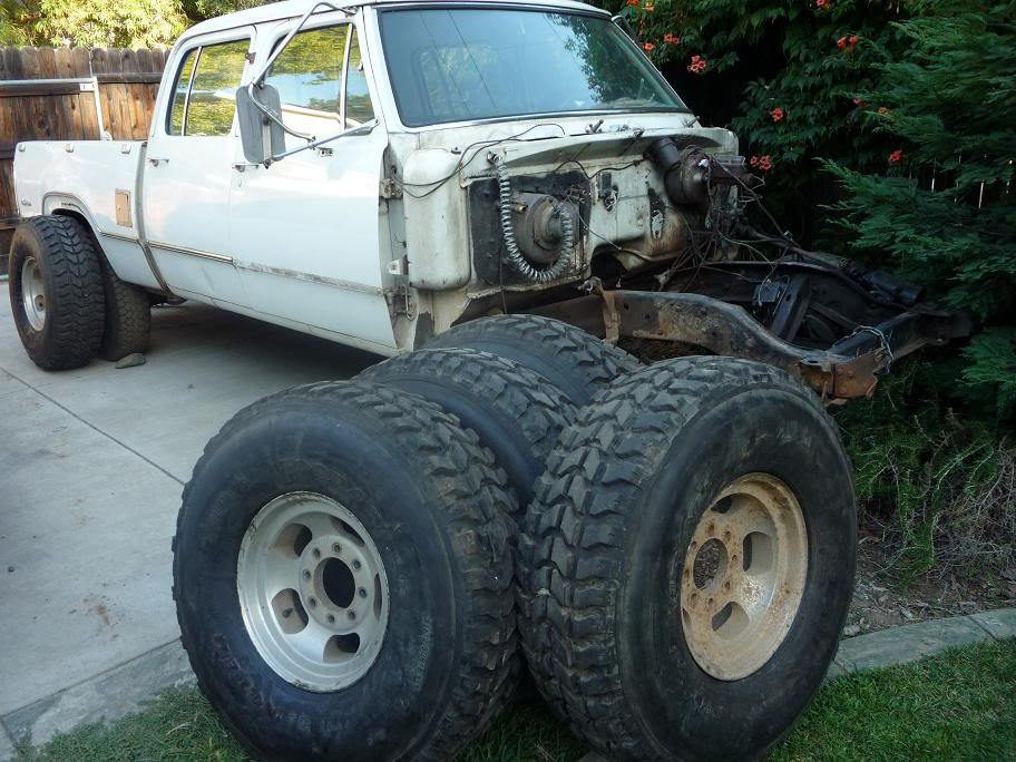

I would love to have a set of the old American bean slot wheels for mine. Something that screams 1970s.

The 2nd gen dodge truck steelies have about 5/8" too much backspace, for a more narrow track, that is visually noticeable. I've run them with the 265/75R16 and had to pull over during a strong sidewind with a cabover camper due to instability.
Also, Ford Econoline E350/E250 VANS are an excellent source of the ford/accuride Ford/Alcoa wheels as they didn't go to 170MM bolt space like the super duty pickups did in 1998.
McNittle> like these?

Exactly. That's good to know about the ford vans. I will probably end up hunting down a set of the Ford Alcoas for mine. Right now I have enough to think about.
