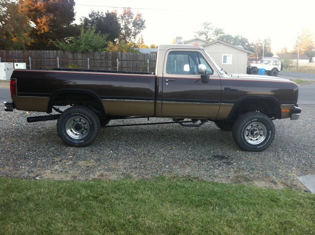

I'm running Ford steelies ("Accuride") off an E350 Ford van -- eight on six-and-a-half as opposed to metric sizing. The rims are 7" wide (as opposed to the 6" wide OEM Dodge rims). The 265/75 R-16 tires I am running require a minimum rim width of 7".
The steelies were originally painted gray and I painted them the same tan color as my truck ("light champagne") -- so they look decent without the OEM Dodge chrome trim rings.
I like the "dog dish hubcaps"
