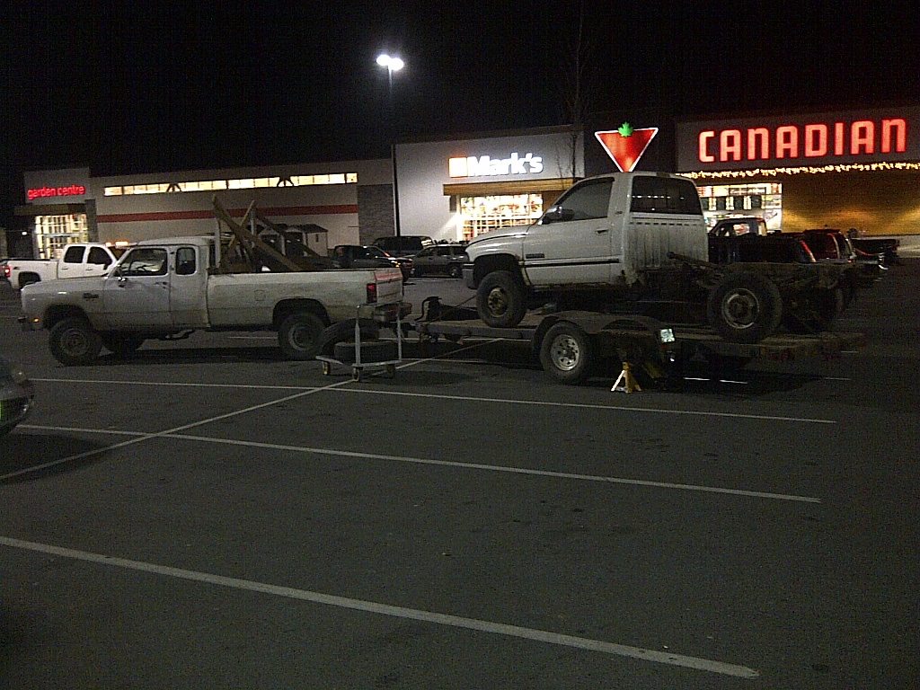

Got my '02 HX35 for free. Love the quick spool. Used it with the wastegate, and added Diamond Eye 4" exhaust at the same time. Thread here
Towed about 8000# yesterday and it was fine.
