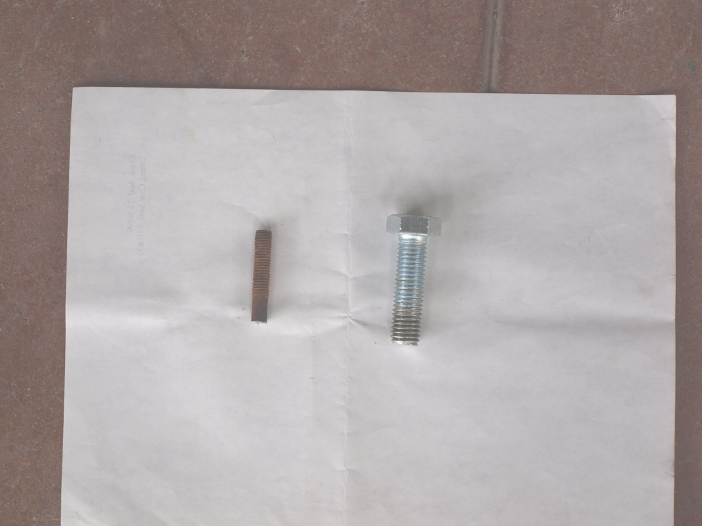

I just did mine. It is a M14-2mm screw. You need the 2 inch long by 8 mm "pin" as described in Jim's post. It is a not that tight press fit. Check the bearing that is pressed on the end opposite the gear, mine was bad and about to fail. I'll get some pics up...Mark P.S. it is an easy job, but you need a press to change the bearing. I also changed my vacuum pots, which are now available rebuilt from A1cardone, through rock auto, less than 300 for the 2.

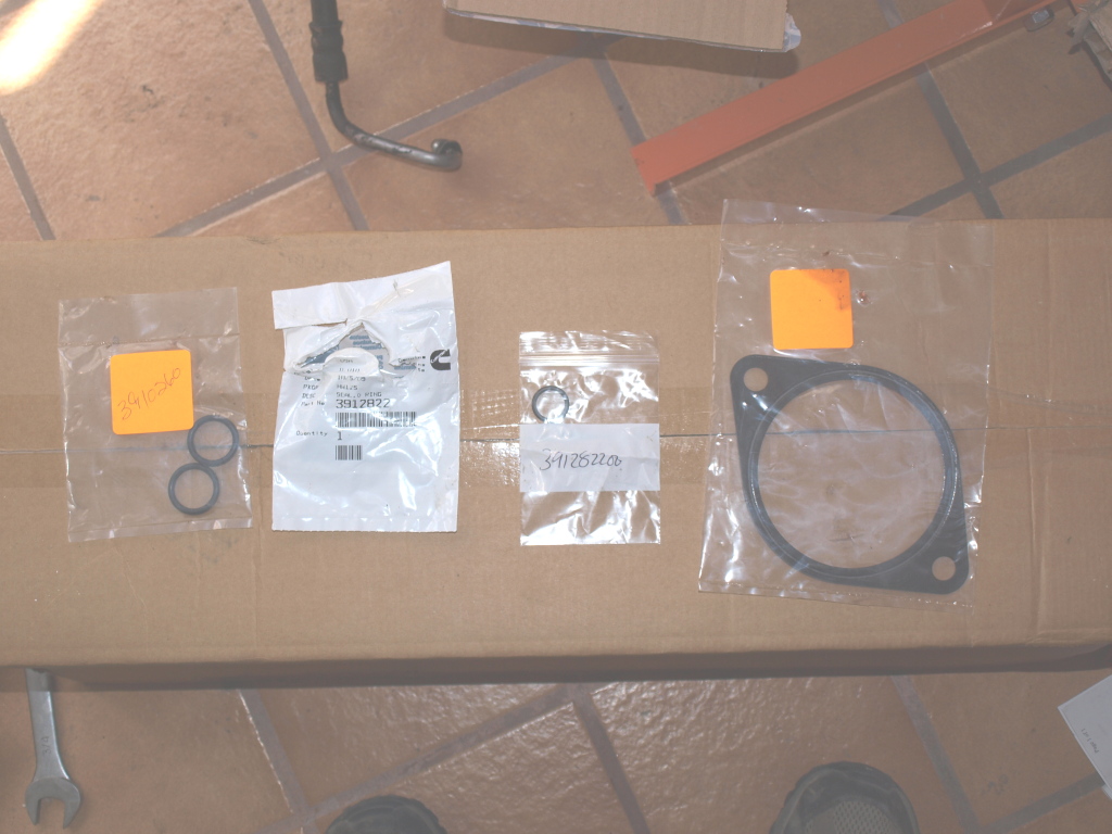

Some Pics
Here are some pics, I also replaced the Power steering pump...Mark

More pics. Let me know if the bearing is bad, I found 1 that was forty dollars less than the local Dodge dealer...Mark
Attached Thumbnails Removing power steering pump and vacuum pump, 89-installed.jpg

Terrific pictures Mark, thanks. Especially for the thread of the bolt, I'll have to run in town and grab one since all my nuts and bolts are primarily SAE.
