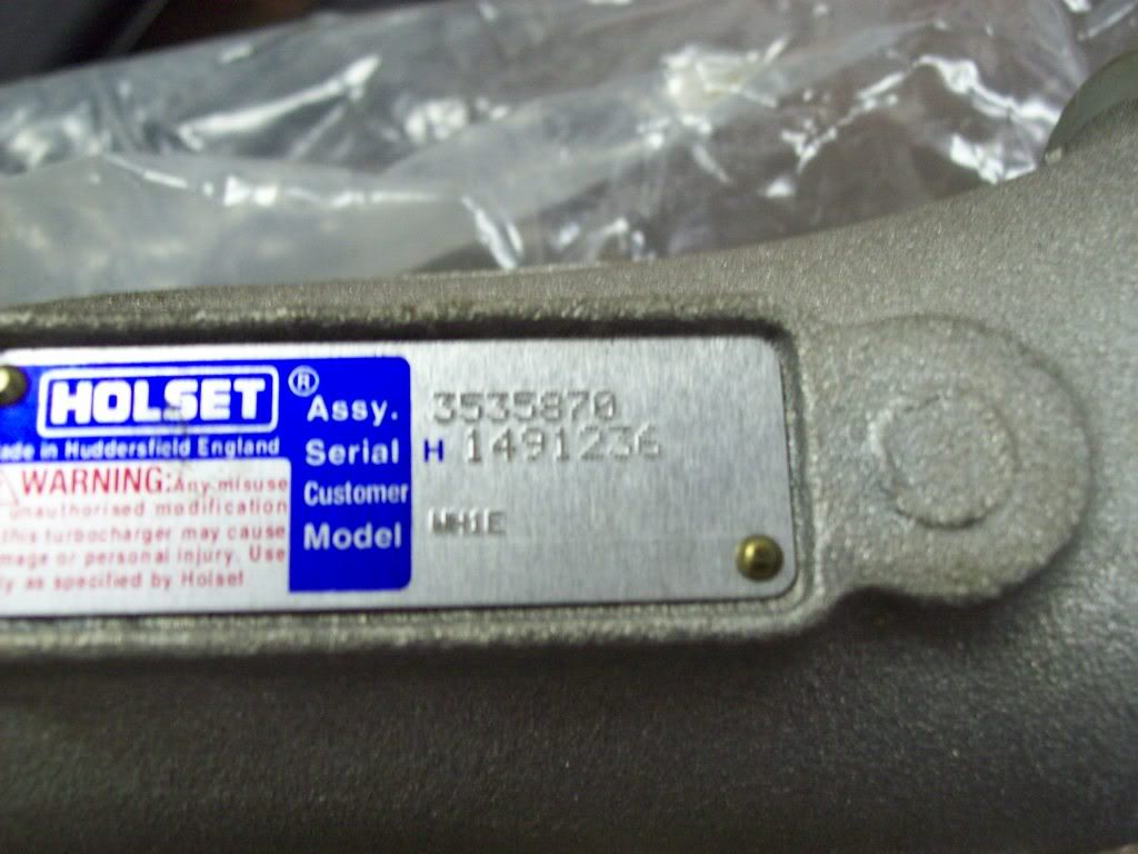

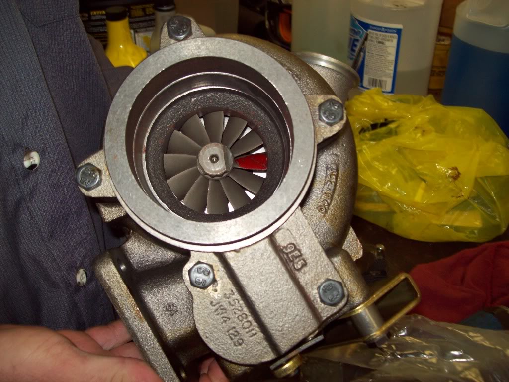

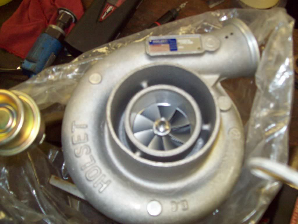

easy question. i looked on alot of forums on how to tell apart super 40's and 40's but my buddy has this WH1E and i was wondering how it looks as far as a real one or a china knockoff
took some pics of it
exhaust side

he wants $300 for it. its got 19 or 16 stamped on it by the flange

i also rough measured the compressor side in inches its 2.5 and converted to MM its 63.5mm

CaptainChrysler's Avatar
Posts: 1,387
Likes: 6
From: Ida Grove, IA
That is a real one.
I think 60mm is as big as they get. But I hope for your sake it is bigger!
Is it t3 or t4? Does it have any numbers inside the exhaust inlet's?
Old Oct 20, 2009 | 06:16 PM
Jer12377's Avatar
Posts: 344
From: North Haven,CT "Living in occupied teritory" & Barton,VT
I see the stamp on the exhaust in the first pic. Its a 19cm exhaust. I bought one off eBay that came off a 8.3 Cummins and didn't install it cause everyone said it will be really laggy, especially with a stick shift like I have.

i have an auto. and i found a 18 cm housing on ebay but i guess hold out for the 16cm? and would it be worth it to buy for 300 and get a housing or to much work? its BRAND NEW. i didnt see anything stamped inside the exhaust housing. i know where its stamped does that 19 mean something else

Is it T3 exhaust or T4 ???
Is it 4" exhaust outlet or 3" ???
I think it'd make a good turbo for hybrid parts but $300 is too much just for that.. and i don't even know if WH1E compressor/wheel would go onto an hx35.
Find out if its T3 or T4 foot and what size exh. outlet...and go from there
Finding an exh. housing for that thing is prob gonna be a pain...i'm not even sure what size turbine wheel it has. 60mm or 65mm ?? thats the one you can see in the pic.
If its a T3 foot and will work on your truck, ask him if you can slap it on there and run it down the road and see how you like it ??? maybe if hes a good enough buddy. hahahah
