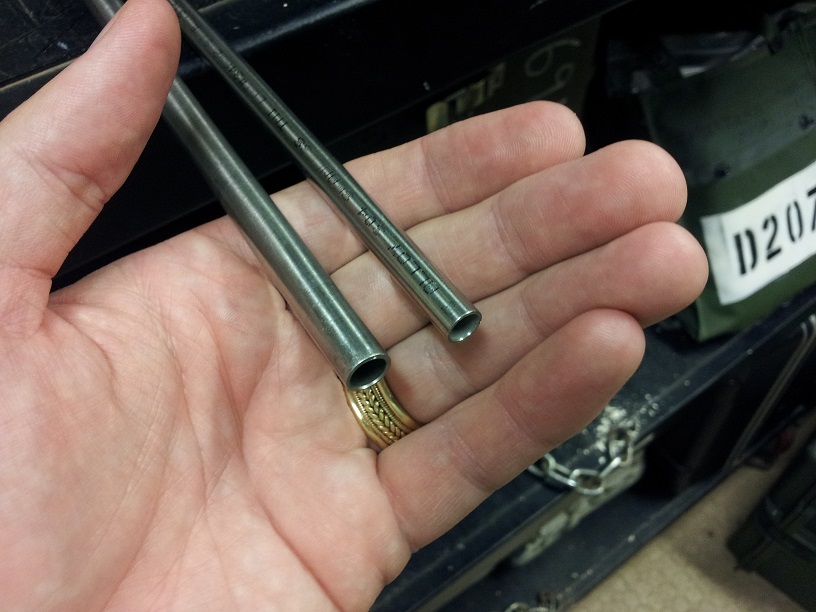

You can also look for small diameter stainless tubing at a hydraulic shop. That would solve any corrosion issues. We have plenty of it in Army aviation units. Attached is a pic of what I'm talking about.

I guess I should clarify about the tubing pic I posted. I confused another topic and thought y'all were talking about the bushings that attach the intercooler to the vertical portion of the core support. But at the same time, you can find much larger diameter stainless tubing for practically any bushing insert you can think of.
