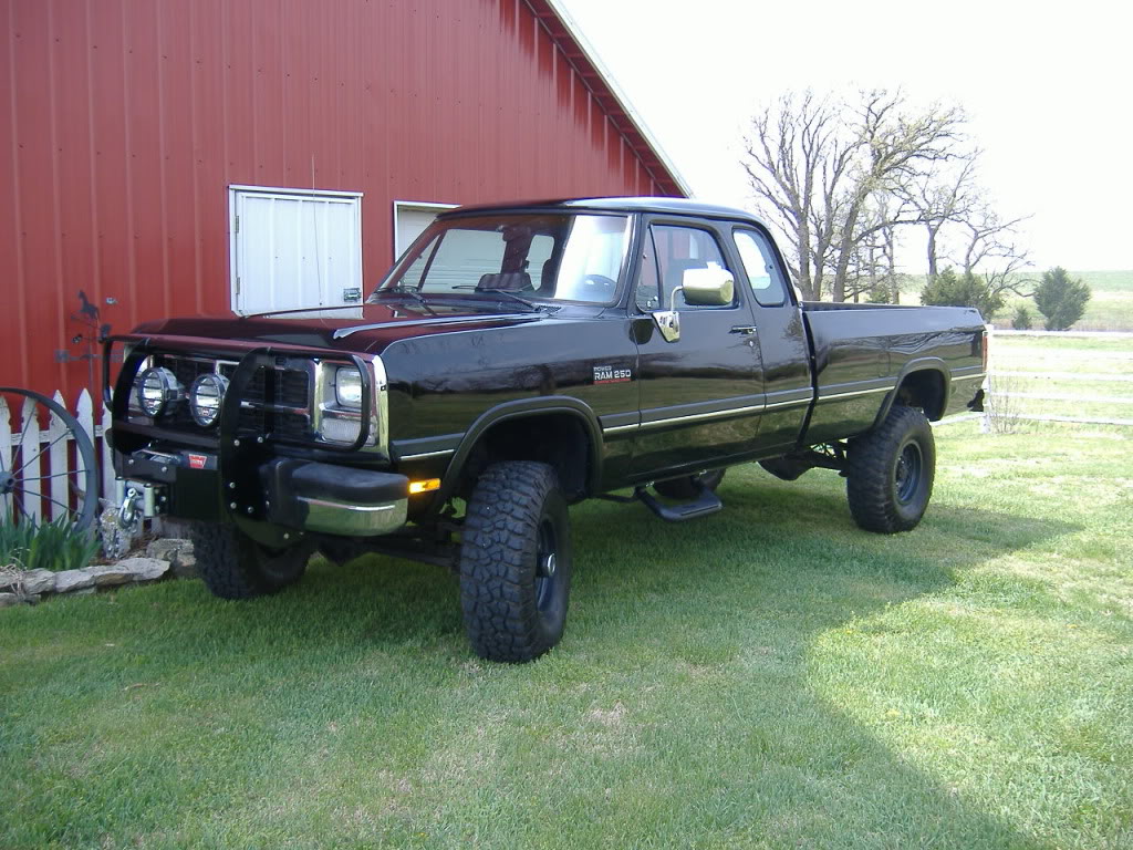

This is a 93 with a 6" Skyjacker lift kit. The stock springs were also changed out for a HD set. Anyway...this should give you an idea of how your truck will set. It also has 315 75R 16's on it.
Hope this helps,
Bill

very nicee rig!! did you use gas springs?
Old Jul 24, 2011 | 04:01 PM
bill-d-c's Avatar
Joined: Feb 2011
Posts: 370
From: ElDorado, Ks
No, their not gas, all the original spring were replaced when the lift kit was installed.
