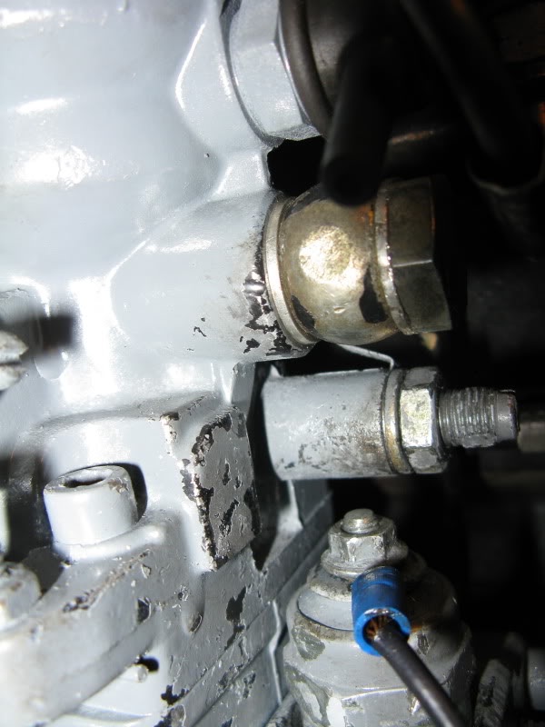

how about some pictures of your indexing, fuel screw and anything else you might have available? we may be able to notice something out of the ordinary.

throttle index:

fuel screw:

Throttle lever looks to be slack - not touching idle screw.
Old Jan 28, 2010 | 09:00 PM
getstucksome's Avatar
Posts: 101
From: Raleigh, NC
I had backed the idle screw out to get to one of the top hat hex bolts. I figured I would adjust the idle once I got the truck running. hahahahahaha. haven't adjusted it yet. Should I tighten it up and try starting it again?
