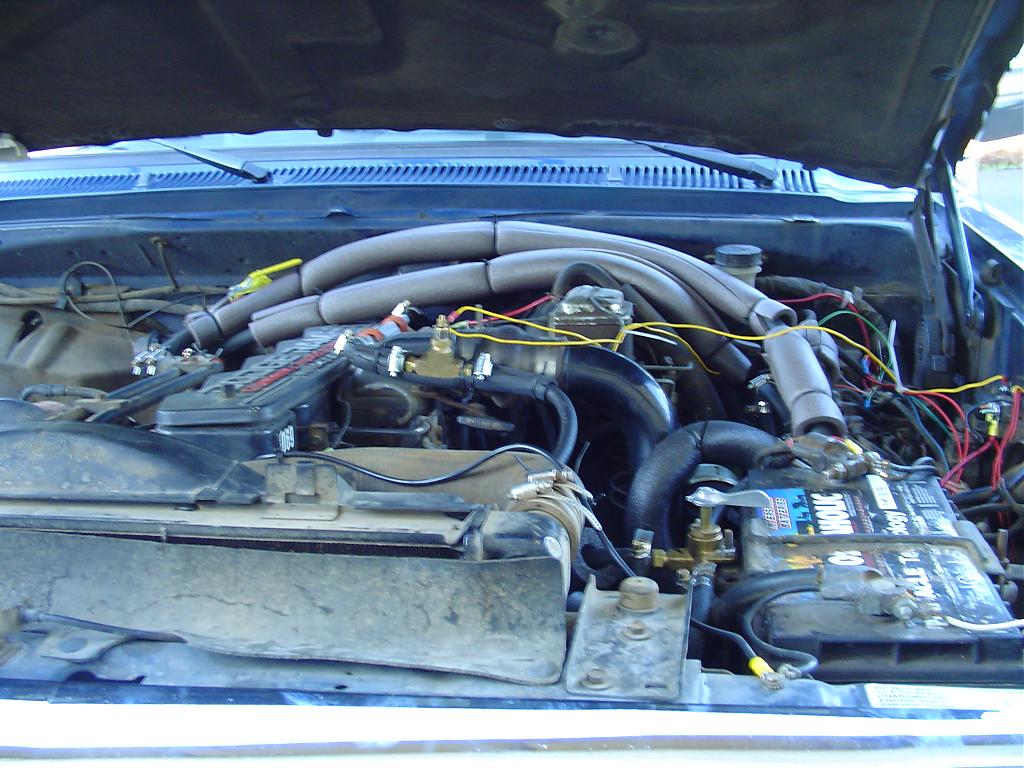

Good luck on the trip. Grease everything, check out your ujoints, have a spare fuel filter or 2 with you if you don't already, change fuilds that need to be changed and drive it. If you have some pics on your WVO system I would like to see them. I have converted a Rabbit and a Benz and am looking to the cummins next. Always looking for new ideas.

I will post some pics of the veg system in the next couple days.

Pictures of the veggie conversion.
