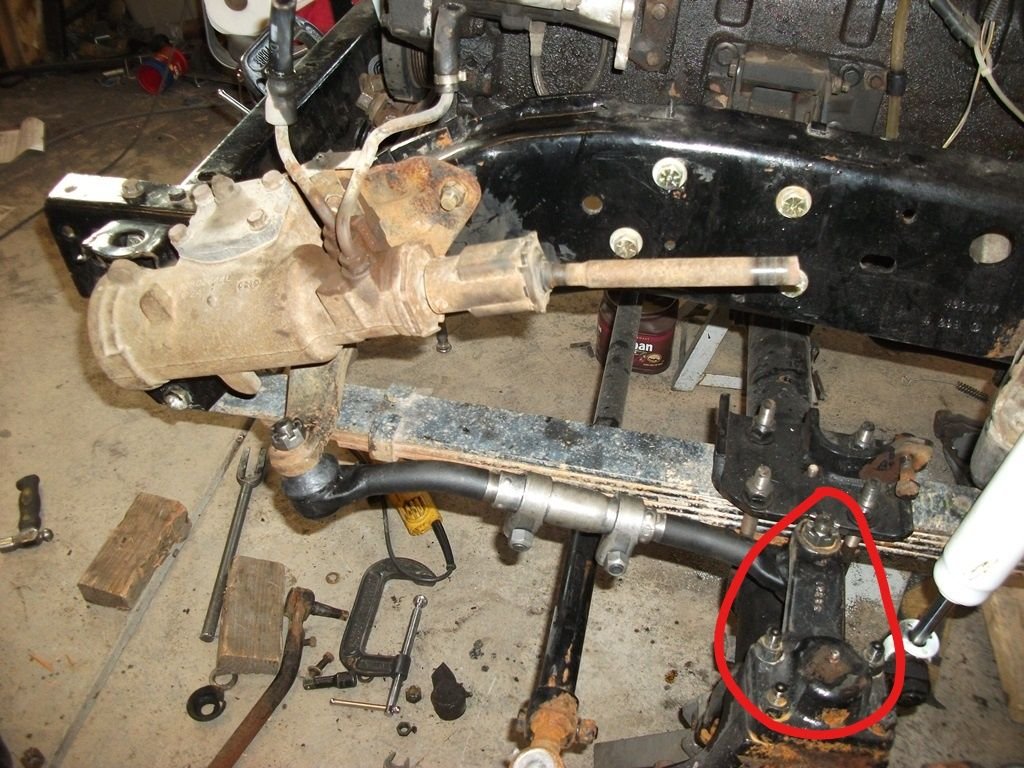

So My truck is done at the body shop and they can't figure out why the steering goes 2.5 turns to the left and 1.5 turns to the right. I told them that the frame is bent but now I'm not sure what if this thing (that I can't find the name for) is bent?
The accident affected the left front shearing the locating pin on the springs shoving the axle back so far the tire was pressed into the fender. They replaced the steering gear box, and drag link trying to figure out why the steering is so off. I have a 2" leveling lift in the front and the stock drag link is not adjustable like the one in the picture and they said the frame was not bent but I'm wondering if this item highlighted in the pic could be bent? It looks pretty beefy but...
Thoughts?

Pitman arm was not replaced. I will have them replace that and the other thing I can't identify circled in the pic. The pitman arm has a keyway so it only goes on one way. I suppose it's possible that the steering gear box was the wrong one ( it was replaced twice thinking that was the issue). The picture is not my truck by the way.

That looks like an adjustable drag link from Sky Jacker. I believe it is meant for trucks with a 4"-6" lift according to most of what I've seen on their web site. If your truck is not lifted that much it could be binding in one direction while you are steering. I would go with the stock drag link.
I was thinking about that adjustable drag link in the picture you mentioned Tim..until I read that.
I have an adjustable drag link similar to that on my un lifted RC 12V and it steers great left and right.
I am thinking the same thing, that would do it.
DOH!!! Missed that one. Good to know about drag link. I often wondered how they would work on an unlifted truck.
