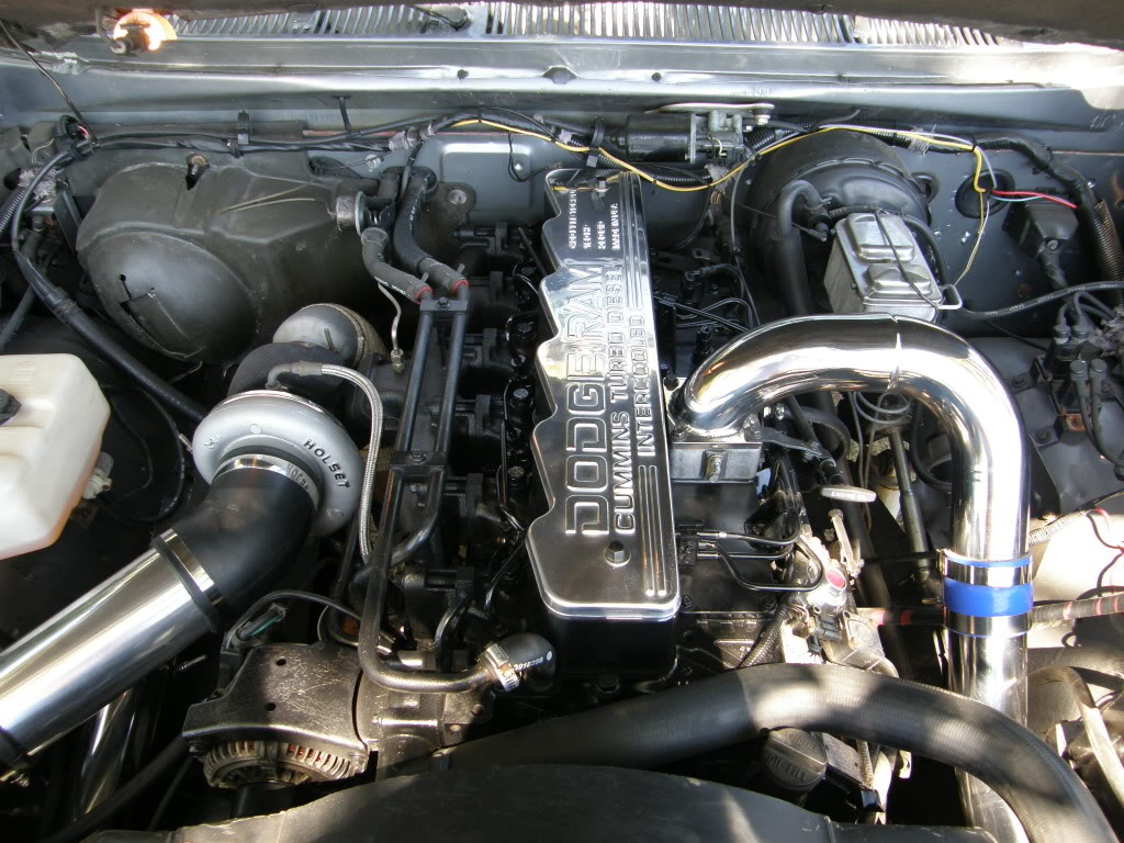

Now as far as buffing your bling, you will need a cloth buffing wheel on your bench grinder...it is a must, along with some bars of rouge from sears or a fleet truck supply house, you just need to use paint thinner on the cover, poor it on and use a 1 inch paint brush with most of the bristles cut off, it will come right off, do not sand it or your tubes.
I got Tim's tubes that were un polished and done it my self ( big mistake) but I got it done.
I think you are looking for something like this.
Old Sep 30, 2014 | 11:33 PM
bigragu's Avatar
Posts: 2,867
Likes: 536
Heck ya I'm looking for something just like that! I've always prided myself for havin a clean engine compartment. I once had a co worker look under my hood and ask me whose the tweaked I bought the truck from. I asked him why he would ask that and his reply was "no one keeps engines lookin like this unless you were tweaking on something, zoning out" . Gotta say with that bling you got there your rig takes the cake!
